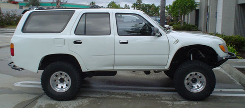

ya i talked to mike a esb and got prices and overall total chaos would be cheaper plus they said i would half to get and engine cage with the esb kit. for the rear i dont want to get bigger coils cause they suck. 3 link is pretty expensive so i might go leaf. thne get fiberwerx custom kit.

That truck was done by protrux. check out www.protrux.net for more pictures.
Basically any kit with coilovers will need an engine cage, especially if you use the thing.
