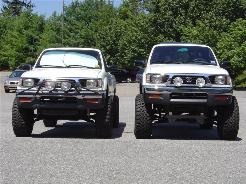

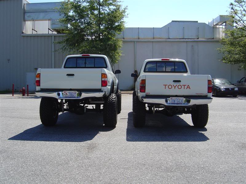

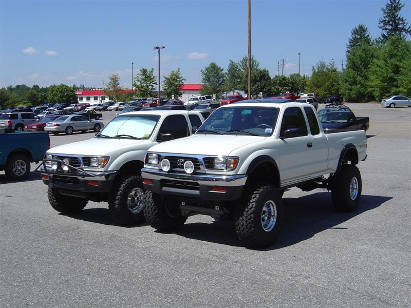

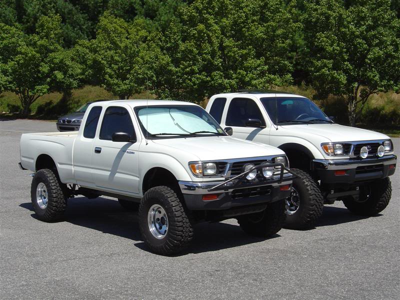

A side by side comparison for anyone who ever wanted to see it before they build it! Wish I had seen pics like this a few years ago. Thought it might help everyone out who's building a Taco. (Especially the newbs!)
Both are 97 Tacomas. One has a 3 inch Toytec lift and a 2 inch RB body lift with 33x12.50's on 15x8's. The other has a 6 inch Trailmaster with a 2 inch RB body lift and 35x12.50's on 15x10's.

Both sweet trucks but how could you not want the 8" lift after these pics...
The 5" lift looks like a lowered mini truck compared to the other one.

Those trucks look nice and I commend you for your hard work on them!
Notice that the truck w/ the bigger tires 35" and more lift 8" has the worst front ground clearance...looks good w/ the trailmaster lift but a waste of money IMO. That is about half way there for a SAS which would give you a "true" lift.

I noticed that too. Brian, why is that?

Is that 8" lift just for the looks? I didn't notice this at first, but went back after reading your post.

The reason the truck with the Trailmaster lift has less clearance is because the bracket kit lowers the diff, steering, lower a arms, etc. to keep the stock geometry, this will in turn give you a better ride, drive better, and be easier on parts like the cv joints, ball joints, etc.. The truck with the 33's either has spacers, taller coils, or coilovers which simply lift the truck due to taller springs and do not lower anything. This truck probably has a pretty stiff front end as did my old tacoma when I lifted it this way. I would also just spend the money on a solid axle swap.
