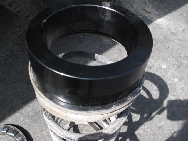

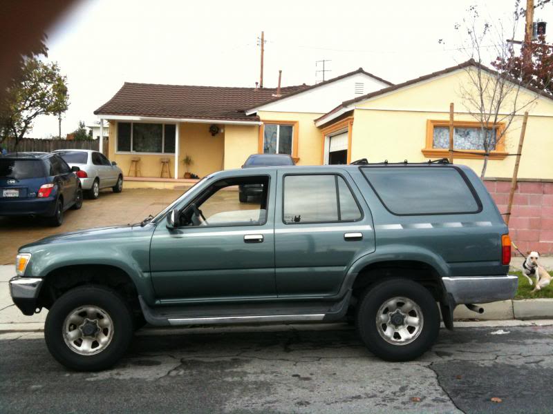

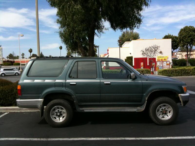

Thought I'd post an update.
I bought 2" spacers from Suspension Connection, who sells through Ebay. Their spacers are machined aluminum and look great, and they have them for 2nd gen 4Runners...or so they thought. Unfortunately, the spacers are 6" OD diameter, and my springs are 6 7/16" OD. So, no go! I called and they mention something about different models having different size springs, but I say bs. They were cool about returning them and said they'd pay the return shipping, and pay for the cost of replacement spacers from another company if I bought them locally. Not sure if that includes buying online....we shall see. I'll report back when/ if I actually get the refunds.
My next choice was from Roger Brown (4Crawler) who has 2" spacers in polyurethane. I received those spacers promptly, and they fit perfect. The customer service I received from Roger is top notch. I highly recommend doing biz with him. We'll see how the poly spacers work out in the long run, but in a couple weeks I'm running the Mojave Road so that should be a good test. Yesterday I ran around town and the difference was night and day. My 4Runner was hitting the rear bump stops all the time, and now the ride is awesome, the way it should be.
Unfortunately I didn't get pics of Rogers spacers, but here's what I have....The wrong spacers, and before and after spacer install-
