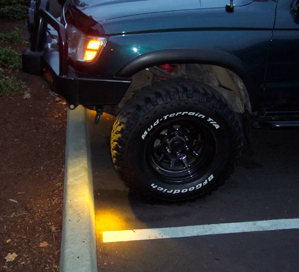

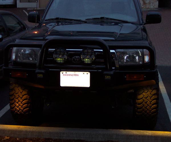

The rocklights were an idea I got from WATRD's Tacoma. I've seen these lights in action, and they are a great accessory when offroading at night. They allow you to see the terrain directly around the tire, something your headlights are useless for. It also helps spotters see whats going on underneath.
I mounted two up under my TJM, illuminating the front of the front tires, and two mounted on the frame lighting up the back tires. It was still light out when I took the pics, so the pictures aren't as impressive as when I checked them out later out. Anyways, I think it looks pretty cool, and is functional as well.
Attached Thumbnails My enlightening weekend (Pics included!)-rocklights1.jpg

Another view:
Attached Thumbnails My enlightening weekend (Pics included!)-rocklights2.jpg

And finally, one more:
Attached Thumbnails My enlightening weekend (Pics included!)-rocklights3.jpg

I like them alot, but need to focus them a bit. I may switch out the bulbs for 100W at some point. It was a pain running the wire up and out of the way.

Hehehe, deefinitely Rob- I was wondering if you'd see this thread. I'm thinking 4 lights won't be enough, I think you had the right idea going with one on either side of the tire?

I like it. I find that I look at the back of the front tire a lot when night wheeling for some reason, so it made sense to have light there.
