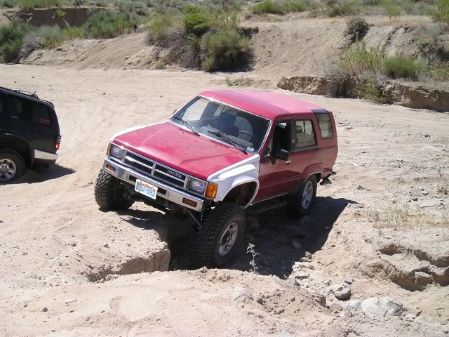

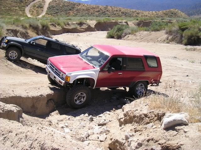

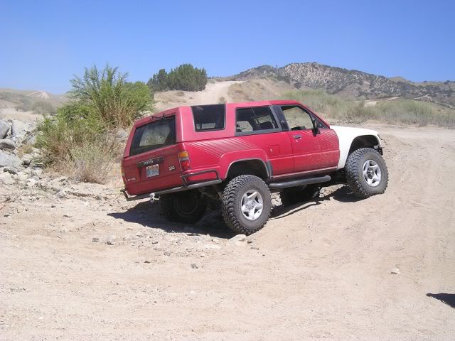

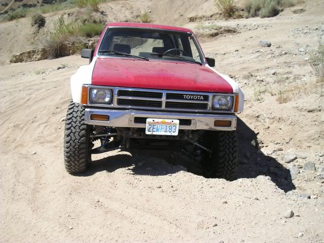

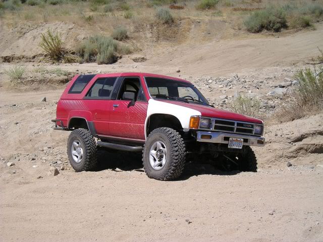

We have flex pics. The rear tire was almost off the ground. If I pulled up on the bumper a little, the tire would come off the ground.

Pinnacle- AWESOME!!!! Your truck looks sweet.
I'm a whore for flex shots. Where were those taken?
You need to find a spot with two humps and get diagonal across it to get maximum flex from your front.
It is really hard to fully compress a front arm in flex. You almost have to have the front really loaded, like flexing downhill.
Softer springs/bars would help and less cranking. BUt I know you and I plan on doing some quick stuff too, so we need a somewhat stiff front end. I am going to try to find a happy medium.
It's so hard to just give up on the quick stuff with a setup like these, but I think if someone built one of these just for trail and used softer springs they would see that these can flex very pretty well. I'm tempted to run lighter tbars, but I know I will be smacking my bumpstops on the quick stuff. I'm gonna try to keep my arms right in the middle of the bumpstops or maybe just a touch cranked.
The static ground clearance of IFS is really nice, but I think I appreciate the flex more, so I'm still owrking on it.

Those were taken in Hungry Valley yesterday. I probably could have went up a bit more, but the rear tire was just about off the ground. I'm trying to find that medium also, Its easier for me to fine tune it with spring rates. But it handles really well in the fast stuff. Except for the rear, but I will be workin on that soon enough.
I dont think he is running t-bars anymore.
