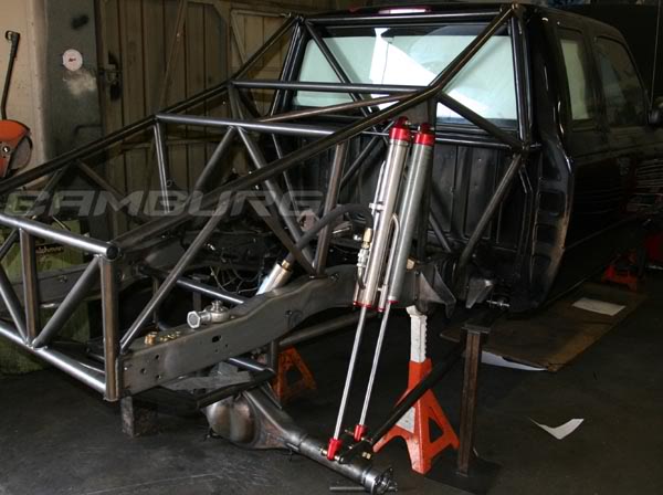

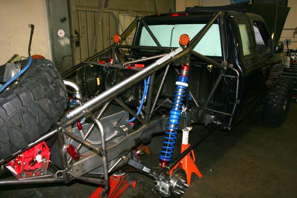

I'm entertaining myself with the idea of linking the rear suspension on mine. Instead of running the shocks off the links, they will be mounted off the axle and at less of an angle shown in the pics. They will probably have to be run straight up and down. Something like this:
Its still just an idea I'm tossing around. No real serious plans for the rear suspension yet.
