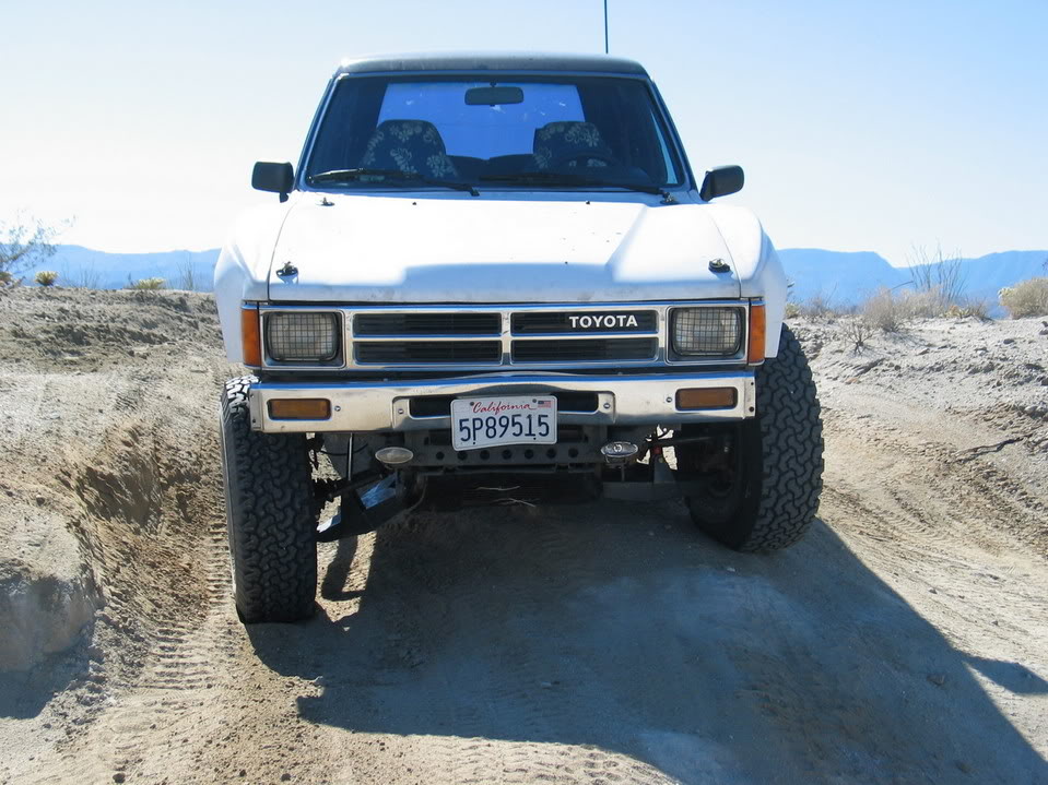

These 3 pics were taken the day I finished the install a couple months ago. Sorry, but I dont think you can see the bump stops, but you can see I am well above level mark on the T100 axles. The other 2 were taken later in the day with my downey rear springs on. They failed miserably in Moab.
http://photos23.flickr.com/33063859_b1cc8b09c4.jpg
http://photos23.flickr.com/33063860_081ab3c1eb.jpg
http://photos22.flickr.com/33063858_91990404eb.jpg
I will try and gets some more pics this weekend.
I would also like to see the same pics of your truck Deathrunner.

and here is a video that shows some flexing going on, right click and save as:
http://sethmetal.com/truckimages/Deathrunner89.mov
This is all with my rear downey spring packs (3") I pounded and flexed em hard for about a year and I never hurt em like you did. I wonder if the large shackle is the culprit in your case.
My rear suspension is completely different now and the runner is less michael jackson like also.
