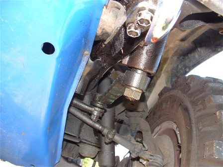

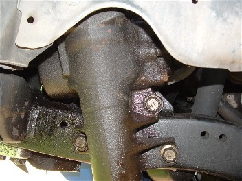

  #34
callmej75's Avatar
Joined: Feb 2004
Posts: 2,518
i see what you mean about that gearbox not having a seal at that specific shaft I was pointing out. Maybe I need to look more on it...it maybe a line leaking on the other side that I can't see. Anyways thanks for the diagram! Will come in handy...

heres some pics of the leak
Attached Thumbnails just bought medium OME coils-gearbox-leak.jpg   just bought medium OME coils-gearbox-leak-2.jpg   just bought medium OME coils-gearbox-leak-3.jpg
Old Apr 25, 2005 | 01:16 PM
  #36
Strap22's Avatar
Sponsoring Vendor
Joined: Sep 2004
Posts: 1,100
From: Dallas Texas
Check the lines first. You know the other alternative$$$$$$$$$$$$$$
Old Apr 25, 2005 | 01:23 PM
  #37
callmej75's Avatar
Joined: Feb 2004
Posts: 2,518
i just tightened a clamp up on both lines and they were pretty loose. wiped everything off and hopefully i dont see anymore leaks!
