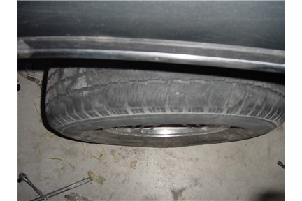

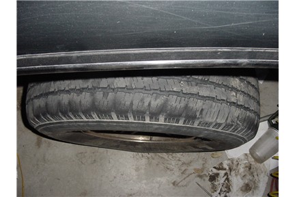

I just got done installing my front super lift on my 93 runner. It just has the front lift, back is stock. I put the stock 31 tires back on and put it on the ground. now both tires are bowed out. the steering wheel is strait and both tires are pointing out a bit. WTF Is is just that my alignment is WAY off or is it something more serious, the sway bar is off and the tie rod ends are in the new mounts but not bolted tight, but that shouldnt matter. I looked at everything for a while and couldnt see anything wrong.
Any ideas, experiences, thoughts.
this whole install has been a PITA
Could the CAM bolts on my LCA's cause the wheels to bow out like each is turning out. I dont have the washer things on the back side for the nuts on the crossmembers and I took or the ones that were pressed in and put them back, but not on the exact position on the head as before, ...its a long story.
Attached Thumbnails front suspension lift problem...help-picture-3333.jpg   front suspension lift problem...help-picture-2222.jpg   front suspension lift problem...help-picture-1111.jpg

Alignment, set the toe in. To get it close, use a tape measure between the tires front and rear at the center line. Crank in the tie rod ends until you have about 1/16"-1/8" toe in, that is the front width is a bit less than the back width. THen take it to a shop and have them set the camber and toe to spec.

Well, rule #1 is to get an alignment after installing any sort of suspension component/lift.
You just changed the entire geometry of it, so it throws the alignment way off.
Its normal!

i dont have any current pics, but i have about 2 degrees of positive camber due to my bj spacers....
driving it is fine with jacked alignment, just dont do it too long or it wiill destroy your tires.... vehicles that have severe toe out problems can destroy a set of tires in less than 300 miles!
