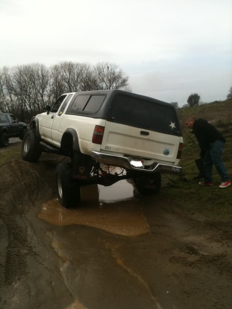

When I did my Chevy rears, I had a 4in bracket lift on the front. The 63's come in 3 packs plus overload for the 2wheel drive, and 4 pack with overload for the 4wd. I had the 4wd leafspring and took out the overload. I also ran the truck with a double shackle setup. Overall I would say it gave me about 3-4 inch lift, no blocks at all either.
Oh and this was a daily driver.

This is my buddy's truck with the 63's double shackle, no blocks
