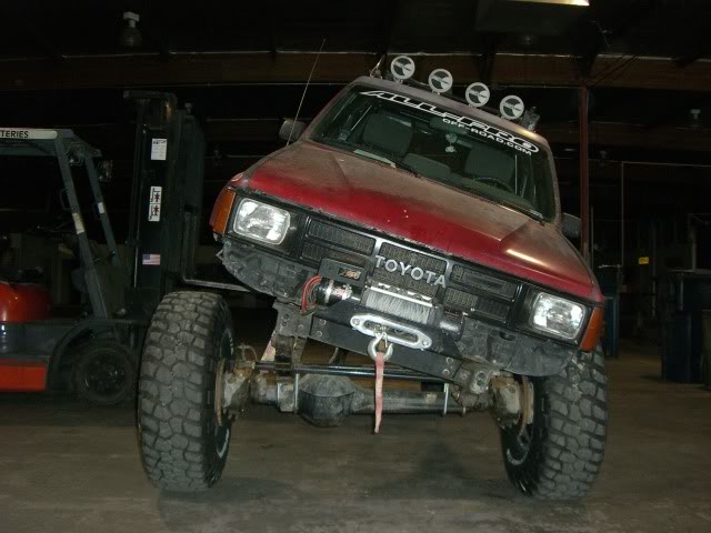

Finally finished with my RUF and chevy 63 swap. Went from a rancho 2 inch lift and 3 inch body lift to RUF and 63's with no body lift. Rides a whole lot better. Also got my 35s mounted. Just need some new shocks now. Here are the pics

Let's see a couple with it relaxed on the ground.
Lookin good with all that flex.

looks awesome! that is some impressive flex!!

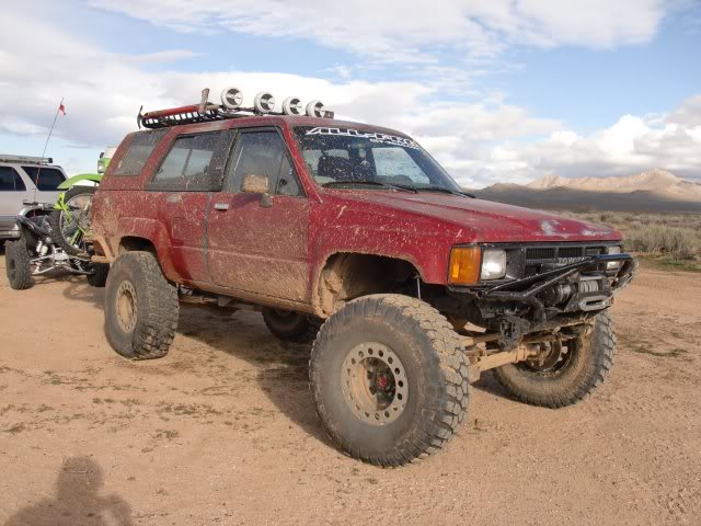

Here a few in the desert but the back is a little sagged out from the dirtbike being on the back. I just used two rear leaf packs and made my RUF packs with 6 leafs
