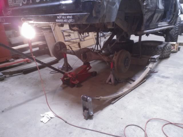

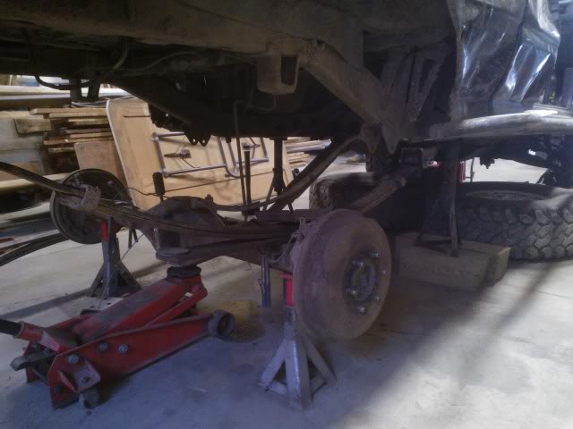

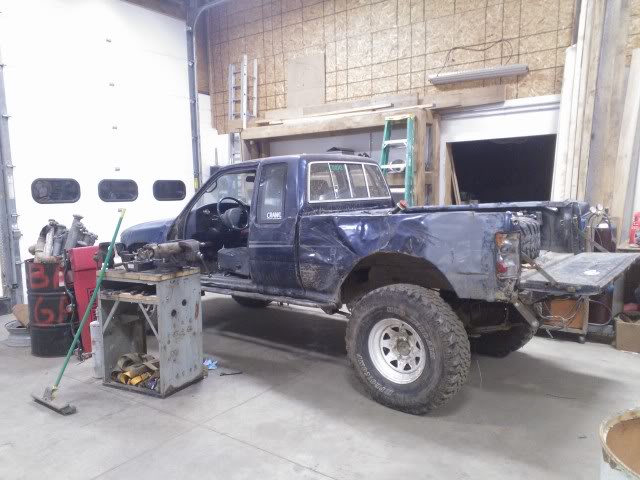

Old Feb 9, 2014 | 05:20 AM
  #38
rattlewagon's Avatar
Joined: Oct 2009
Posts: 4,832
Likes: 332
From: Northfield, Vermont
Barry&amanda, BJ spacers should even it out nicely.
Originally Posted by Gizler00
Did you go with a 2wd or 4wd pack. I'm not sure which one would be better for 854runner
They were 4wd packs off a 2003 1500. 2 leaf plus overload. Not ideal, but they were really cheap.
