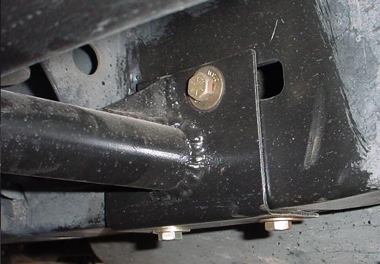

Pic of one of the brackets during install

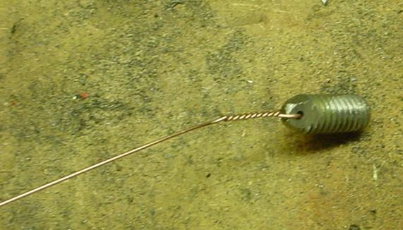

This is the tool I used to fish the nuts and washers into the frame, where I then held it in place with a nut on the outside while I drilled the holes for the rivets and then riveted them in place.
