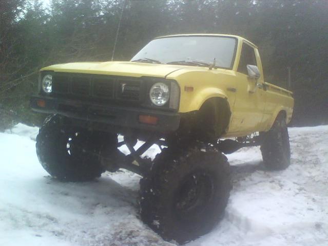

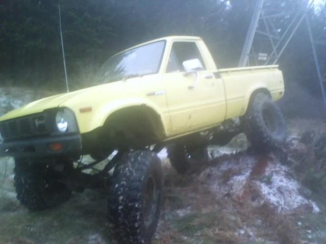

its about 2.25 inches longer than the last springs i had on it...here are some pics of ow it down travels but if you look close you can see that the passanger tire doesnt travel up at all!!!! also...what about a boomerang shackle???
Then a shackle about that much longer than stock is what you need. Wide body or boomerang design helps with clearance around the body mount bracket where the shackle hanger sits inside of.
