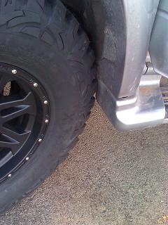

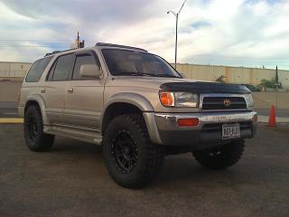

Finally some pics
Originally Posted by 94Runner4x4
take pictures of everything as is now and it'll be easier to tell you...
My current setup with the front OME installed as of yet..
Front with fenders on..
Pulled fenders off until BL install..
Attached Thumbnails 1996 4runner suspension/body lift - Whatcha think?-stancea.jpg   1996 4runner suspension/body lift - Whatcha think?-fronta.jpg   1996 4runner suspension/body lift - Whatcha think?-drivers-fronta.jpg

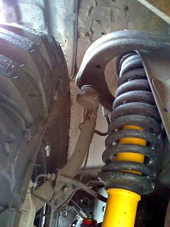

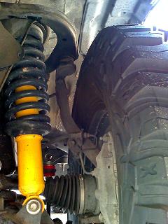

Originally Posted by pdyebrasil
So when you go up 2.5" on a suspension lift lift and 1" on a body lit you need to widen the track with 3.5" backspaced wheels and 12.5" wide tires. There are no wheels wide enough to equalize the vehicle over this combo.
I think that I have to go with either 1.5 or 2" wheel spacers since my tires are 12.2" wide.. :O Those a-arms are pretty damn close..
Guys.. with wheel spacers... will I get more fender rubbing due to the tire stickin out??
Any questions/comments/suggestions very welcome!
Attached Thumbnails 1996 4runner suspension/body lift - Whatcha think?-drivers-side-rear-front-wheel-wella.jpg   1996 4runner suspension/body lift - Whatcha think?-drivers-side-arma.jpg   1996 4runner suspension/body lift - Whatcha think?-passengers-side-arma.jpg

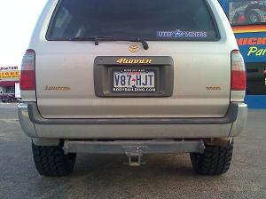

Originally Posted by crolison
You should be able to run the 285/70's without the bodylift. I am not a huge fan of body lifts and would much rather start trimming than run them. I liked the rake look. You can flip your hitch to make it closer to the normal way it looks. Your mileage will go down.
Yeah I ended up runnin the bigger tires, but in reality the 305's are .2" shorter vs. the 285's, but they are .7" wider I'll prolly end up flippin my hitch, is this a pretty easy procedure?? I'm going to end up with a rake look pretty soon after the rear susp install.. My gas mileage is currently about 18.5-19mpg, mostly at about 70mph
Attached Thumbnails 1996 4runner suspension/body lift - Whatcha think?-backa.jpg   1996 4runner suspension/body lift - Whatcha think?-passenger-fronta.jpg
Yep, wider the tire sticks out the bigger the arc is sweeps while steering left and right.
