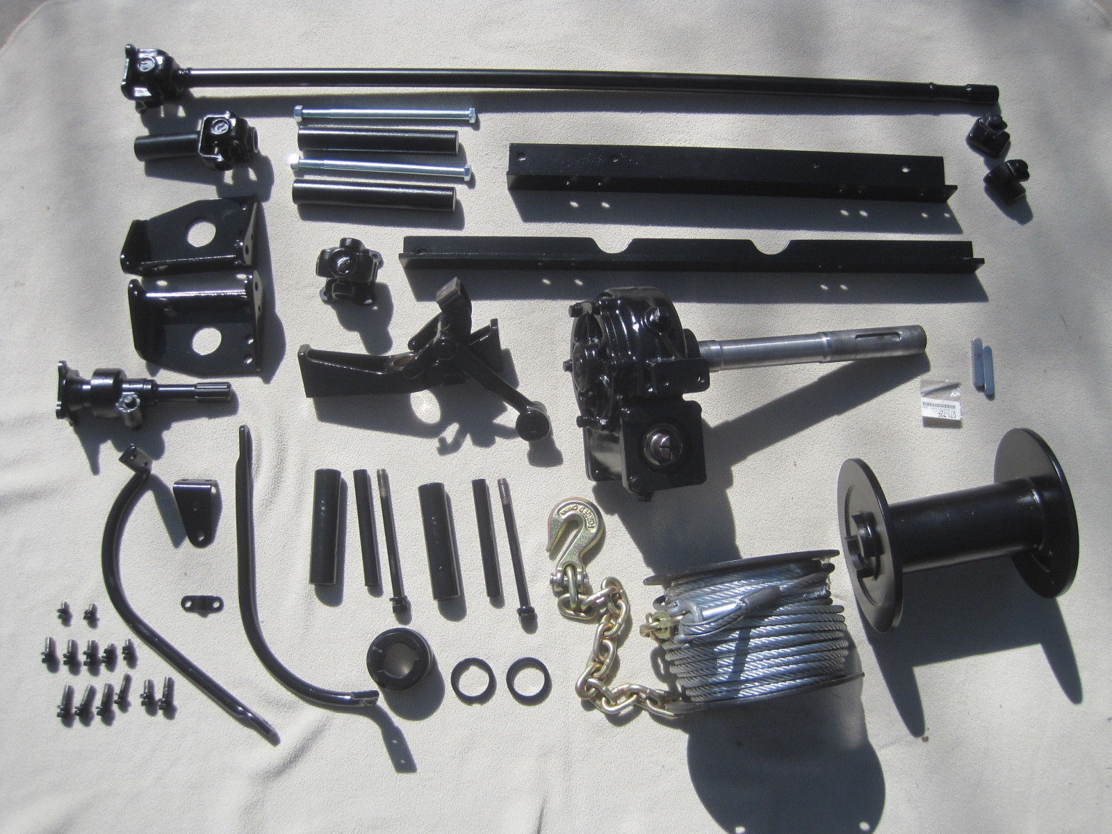

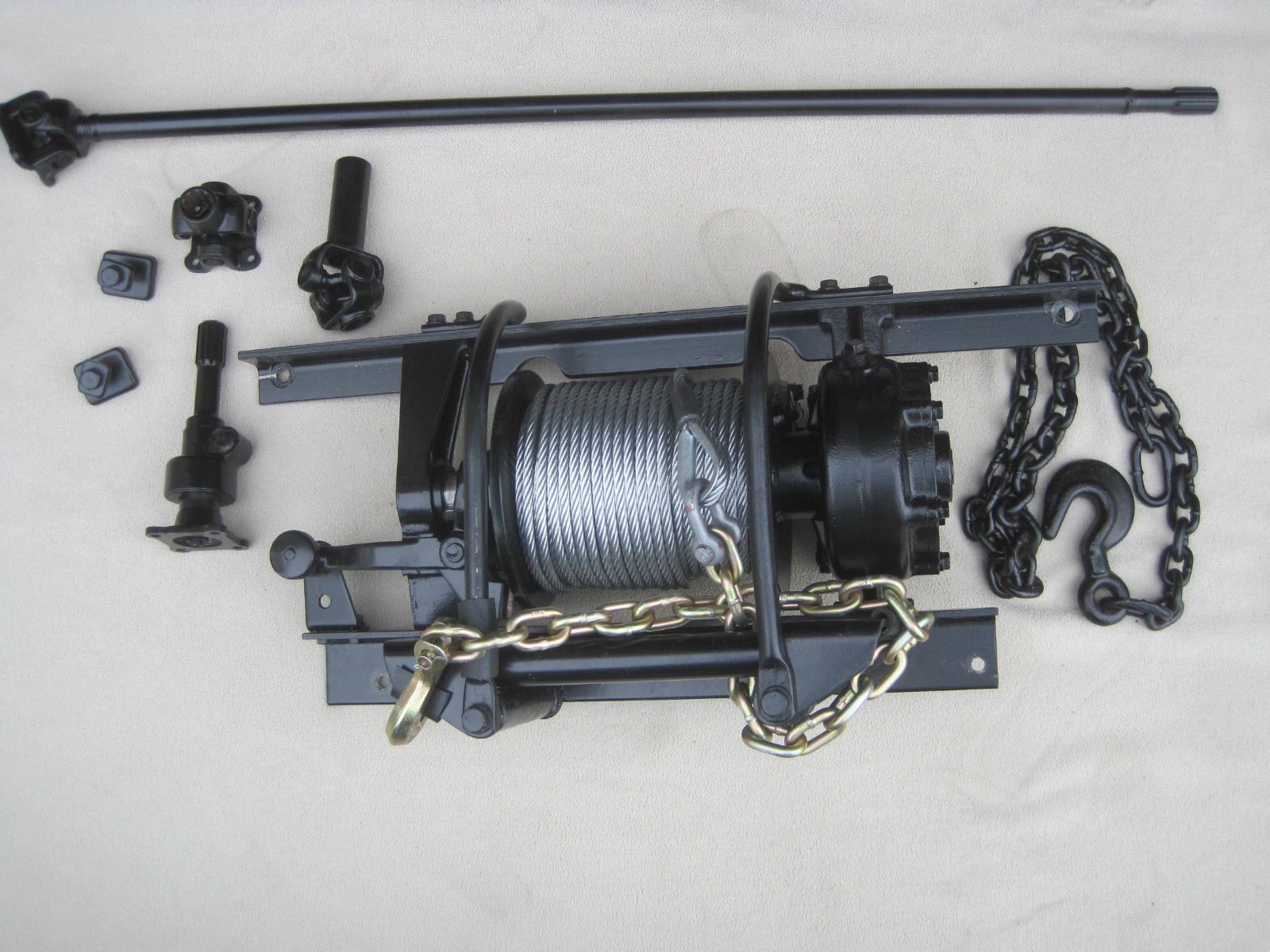

I bought this last week and would like to know other than a PTO gear box and in cab floor shifter which im trying to locate what else do I need that im not aware of to use this on 79-83 FJ40?
Attached Thumbnails Bought a Toyota PTO winch, what else do I need?-14.jpg   Bought a Toyota PTO winch, what else do I need?-15.jpg   Bought a Toyota PTO winch, what else do I need?-16.jpg

You are going to need the correct PTO gearbox for the trans/transfer combo you have. I have a 1970 with a 3 speed trans/transfer, and to put in a 4 speed trans, the PTO gearbox will not work..... My dilema.
Extra shear pins are nice to have. Floor shift boot and lock-out cover plate for the PTO lever. Looks like you have a complete winch though.
