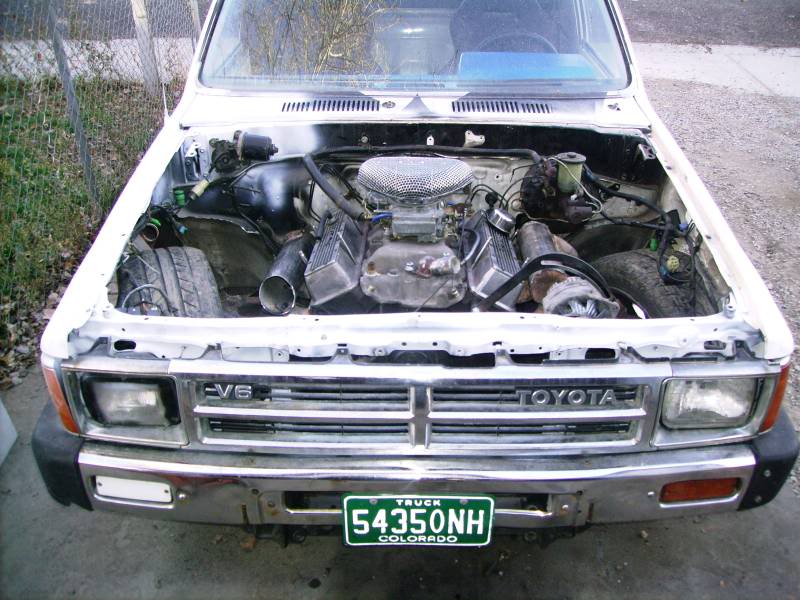

i have killed a few 7.5 diffs with my 84 2wd yota with a sbc 283, and finally switched to a 8" housing with a 4.10 v6 diff and had no problems after that. i (with experience)would not recomend a 300+ hp supra motor in front of a weak 7.5" diff.

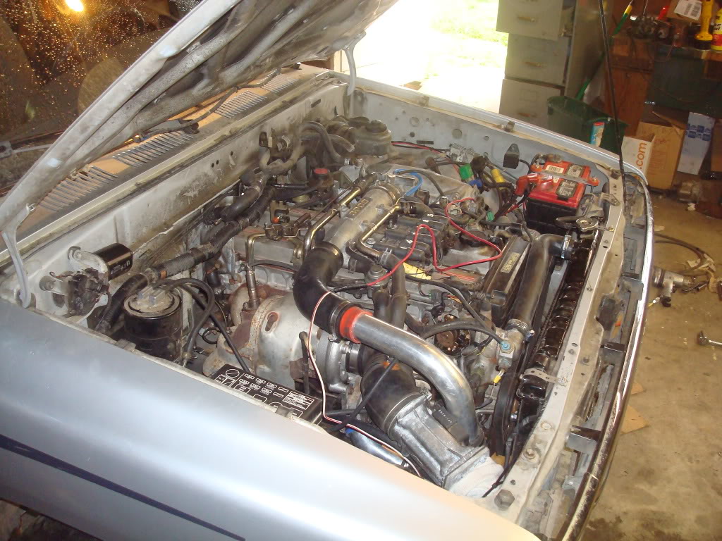

the swap is done!!!! i've been driving it for a couple days now and i really like the extra power. running stock boost for now. the sound and rumble of the 7m makes people think wtf is going on with that little truck lol! just the small amount of time driving it i realized how much it needs different gears. low rpm in 5th is like 85-90 mph! way to fast to cruise. i'm set with finding a front 3rd member out of a 4x4 but i don't know what to pay. i don't want to get ripped off. the local salvage yard said 175 for one. they have a good amount of mid 90s 4runners but not many trucks. i would like to get between a 4-4.5 to 1 ratio. what models have that range? are the autos ratio much different from the manual? how much should i pay? or is there a place to get a good deal on a new r&p for mine? sorry im such a noob with this stuff. and heres a pic of the 7m in there. its a tight fit!
