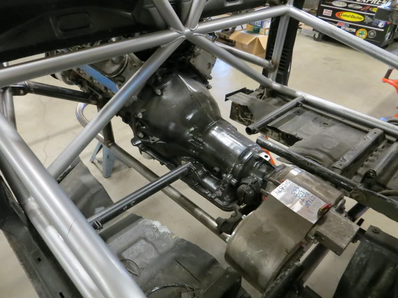

Lots of set backs this last week, mostly stuff unrelated to the build. The tube I had coming for the subrame was the wrong size so couldn't get that done today. But I did manage to get the motor bushing tabs in place and some more tube tacked on.

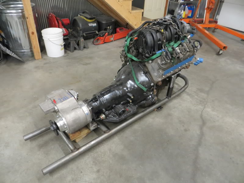

LS powered sled?

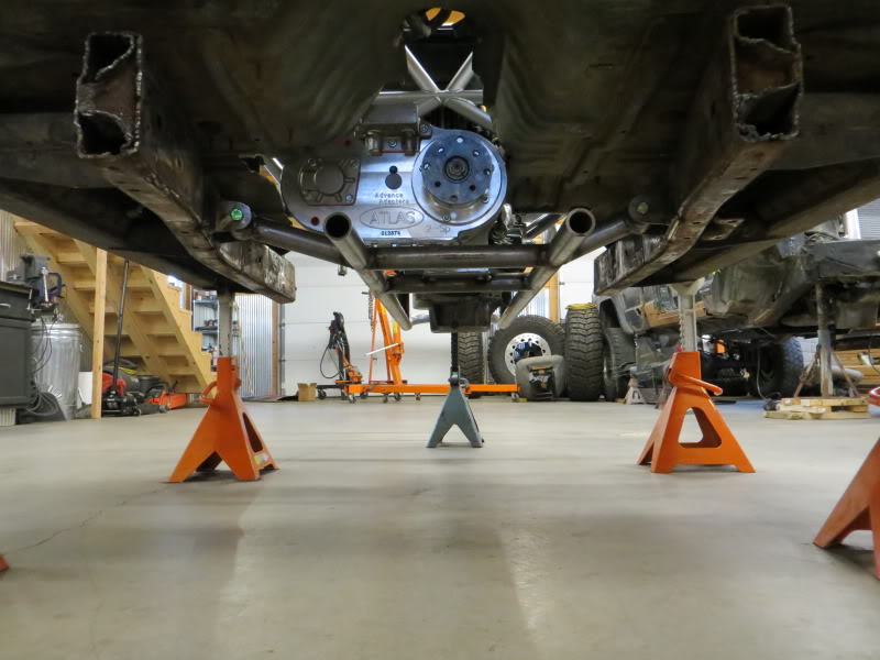

Finally, motor is in place. It's offset to the driver side 2" in order to make room for the passenger seat. Otherwise the shift linkage would be inside the seat. Bottom of the subrame tube is 2" lower than the bottom of the Toyota frame rails.
I seem to dent .120 DOM on my roof so I thought I better step it up some on the bottom. 1.75x.188 wall on the subrame and 2x.250 going to the motor side mounts.

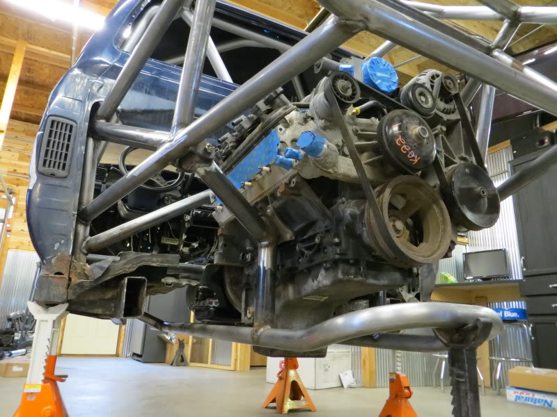

There will be another set of legs and bushings by the torque converter somewhere, depends where my lower link mounts end up. The carrier bearing for the rear driveshaft will also mount there. There will be a few more tubes added to gusset things. Oil pan will get swapped and not be hanging down. The entire bottom frame rail to frame rail will be skinned with UMHW.

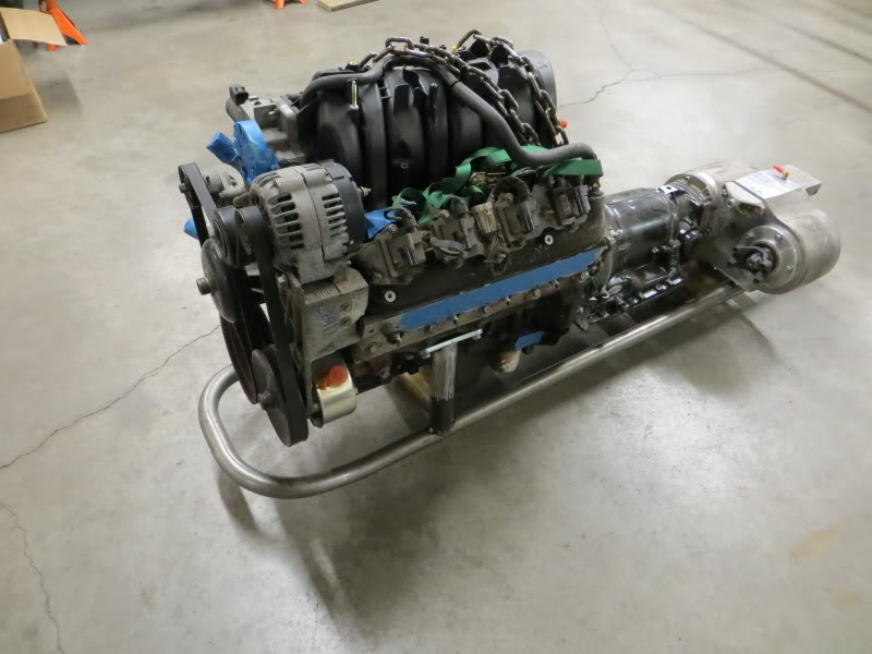

Not sure how the front is getting finished off yet until I get the front lower link mounts in place.
