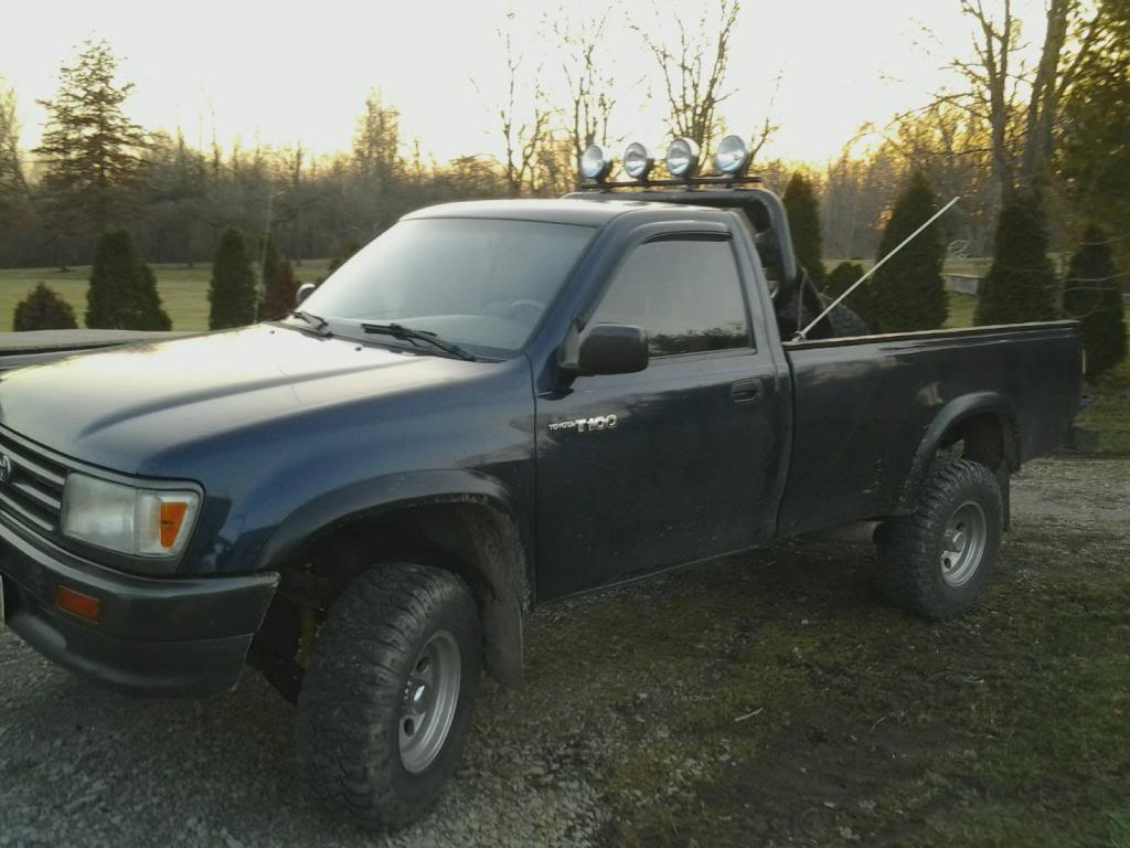

Howdy! I have been consulting this forum for everything I do to my truck but now its time to make my presence known!
I have a 1993 Toyota T100 3.0l 4x4 with 5spd transmission, it has 180k miles and runs great, its my daily driver. It has a new Jasper engine that was installed 8k miles ago with a new clutch. Next to no rust.
Modifications include:
Aftermarket rear bumper (not sure what brand or if custom made)
Exterior lights
Fender flares
Custom 4 cu ft ported sub box with 2 12s and 1400 crunch amp with pioneer coaxle door speakers
interior lights
Jensen DVD player
CB radio with bed rail mounted antennae
Custom fit roll bars with 2 offroad lights
Custom spare tire mount
Toolbox
2" lift on rear
Cold air intake
Custom sidepipe exhaust
Mickey Thompson MTZ 31s
Chrome bullet hole rims
Custom paint
Undercoating rust protection
EGR Delete
timing adjustment (14 degrees)
My plans are made around my uses for the truck, I have the truck for a daily driver. I live in ohio, its usually too muddy out here to go off roading, you just sink and i prefer rocks to mud.. so my plans are more for looks than performance, i do however use the truck for work and dirt roads (when theyre actually dirt) I am a college student so Total chaos and whatnot are out of the question!
I was using this build up thread for help and ideas on modifications!
Plans for near future are:
2 or 3 inch body lift (is 3 too much?)
Headers (any brands that sell headers for less than 500?)
33's
offroad bumper with stinger (anyone know where to get these? i can fab a stinger but i cant find ANY bumpers for sale, im not a fan of the brush guards either)
offroad lighting
more horsepower!
Any comments or ideas are welcome! Pics very soon.

Installed 1.5 inch bj spacers and shocks this weekend, out to get pitman and idler arm soon.

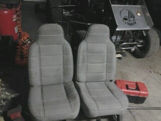

got bucket seats out of a jeep cherokee at take-a-part. They didn't have any 4runners or pickups but they had a 96 2wd T100, what are the odds? The seats bolt right into the outside mount perfectly and line up well for inside bolts, but they are about 3 inches too tall! im going to try shortening them 2 inches buy cutting 2 inches out of the middle of the bolt mounts and welding them back on. not sure how well this will work, but if it doesnt then i will just make new mounts 3 inches shorter. i also took the middle springs out of the bottem of the seat and left the 4 corner springs on (if that makes sense) it lowers me about an inch and is much more comfortable.
