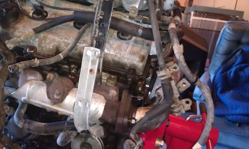

I am wrapping up a ridiculously long engine swap on 96 T100 with a 3.4L engine. I cannot for the life of me figure out where this bracket goes!
Any help would be appreciated

What does the other side (inner) look like?
Doesn't look familiar to the T-100 setup.

Bolts to the lift point on the driver's side.
'96 4Runner 3.4:

Awesome. Thank You!
