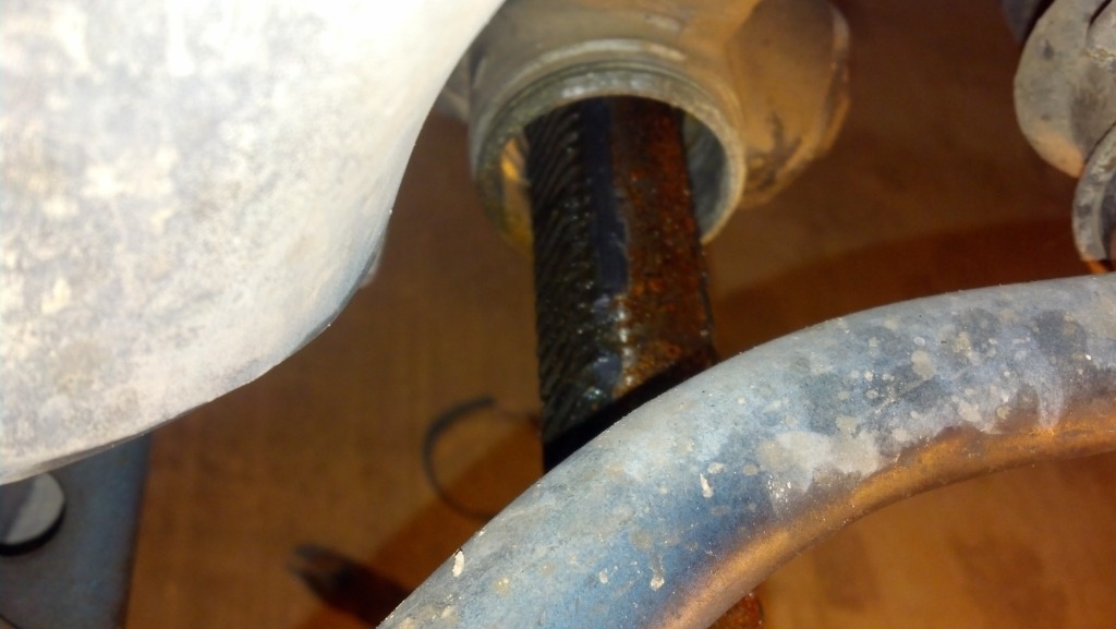

Well I started with the tie rod ends. All was going smoothly until I got the boot off the inner tie rod. Anyone see anything wrong with this picture?
How do you guys feel about a rusty rack? It doesn't leak a drop of fluid and the teeth are clean from rust and in good condition. Oh well...

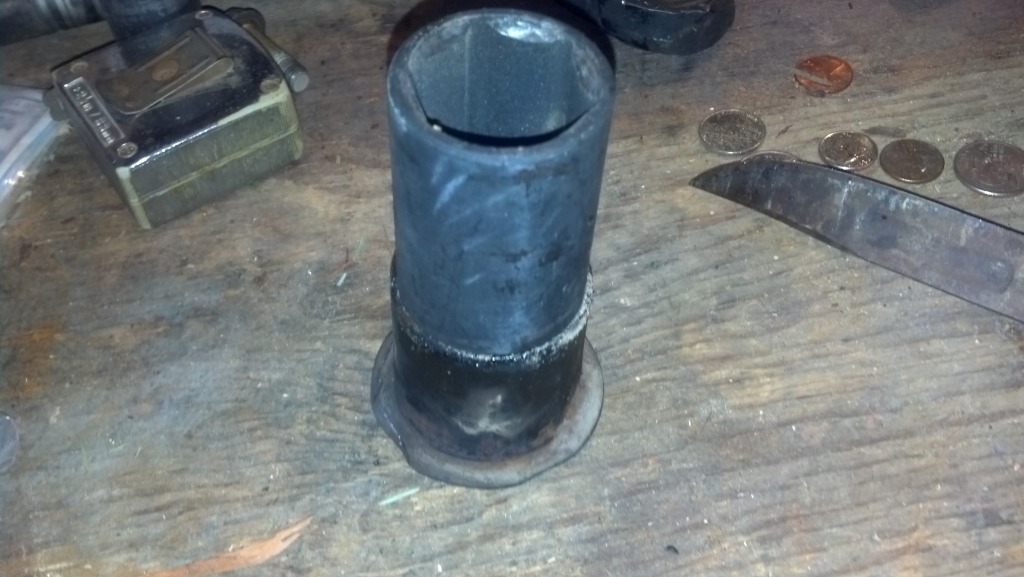

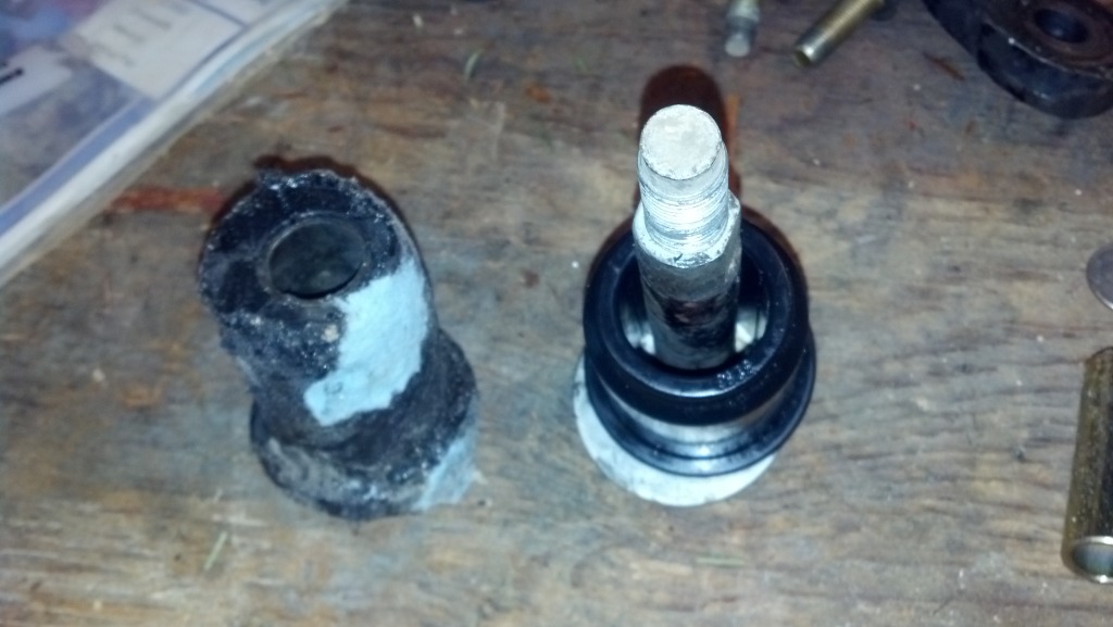

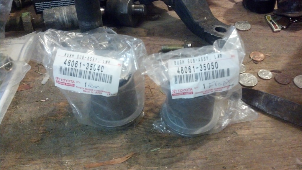

So I finally got the bushings figured out. The dremel cleaned it up nicely. Went to put in the new poly energy suspension bushing and guess what:
So I called customer service at Energy Suspension (where I ordered the polyurethane bushings from) and they took some time and looked at it and determined that the bushings I had weren't stock bushings. When you get their poly bushings you have to reuse all the metal parts, and since the bushings I had didn't have the right metal parts, so I went this route:
Found a really cool thread on how to remove old bushings without a press (thanks to Habanero):
https://www.yotatech.com/forums/f2/f...rd-gen-265072/
So my problem then was to get the old metal sleeves out. I went for my bottle jack but the jack was too narrow and just slipped through the metal sleeve. I was like "great now I have to find a washer or something that is bigger than the metal sleeve but smaller than the opening on the control arm!" I didn't know what to do. My first thought was to see about my impact sockets. Viola! 32mm impact socket from harbor freight has a lip on it that fits perfectly inside the sleeve and the outer diameter of the socket is just a small amount bigger than the sleeve:
(picture is after the sleeve is out)
Now I finally get to start putting the drivers side back together.

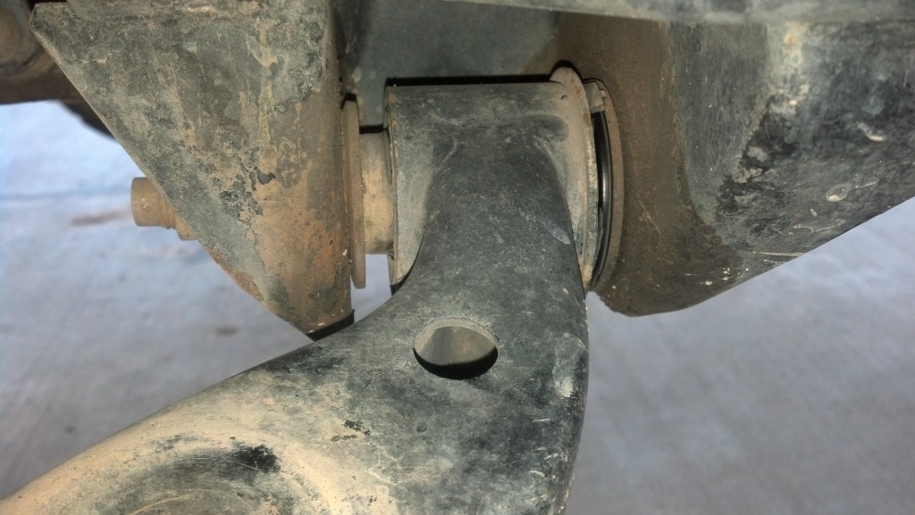

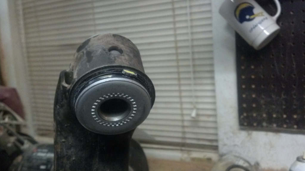

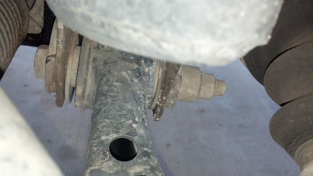

Well... I get the bonehead of the month award. I but the rear bushing in backwards.
Did I mess this one up? Can't figure out an easy to get this one out. Might have to take it to a shop with a press friday. Would having it pressed out ruin it? Would it be ok to mount it like this? I really have no clue.
Old Feb 21, 2013 | 04:06 AM
  #58
habanero's Avatar
Joined: Sep 2005
Posts: 8,247
Likes: 497
From: mo
Now that's an interesting situation. Given the way the bushing and a-arm fit I don't think it could go as-in into the truck. Even if it did you'd be lacking the protection the metal flange provides for the forces between a-arm and mount.
Guess the biggest problem with pressing it out is finding something to push against and something to drop the bushing into? Gonna be a learning experience, would love to see what you end up with.

Well I finally got to make some progress today. I almost got done. I got to finally use my new torque wrench and it was nice. Playing with new toys is always a good time.
Yesterday I had a buddy help me get the backwards bushing out. He's got a welding shop and I had an elaborate jig in mind that we could make to hold the control arm and the bottle jack. Then he looked at it and said "I've got a big vice, lets try that." Whatta you know, the vice worked. And all this time people tell me to get rid of my vices. Sheese.
It was definitely jerry rigged. I didn't have my phone but he took a picture. When he gets it to me I'll post it up.

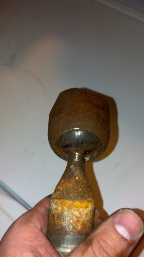

Anyways tore down the passenger side and guess what I found?!
Nasty (and wayyyy to much play)
I thought the boot on that side of the steering rack was ok but turns out it had a hole in it (explains the rust I guess).

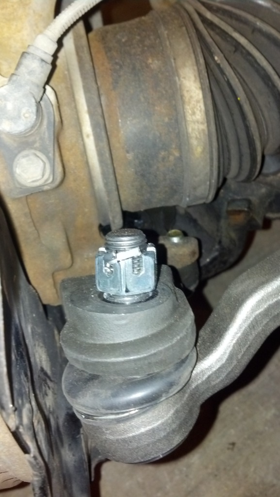

Everything else was run of the mill. Followed the FSM and a couple write ups and it went easy as pie until I was torquing the last nut before I put the tires back on.

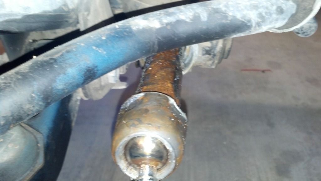

It was the drivers side outer tie rod end. Set the torque wrench and started turning. Then I kept turning, and turning, and turning. I never got very much resistance. I thought maybe the stud was turning in there and when I took the wrench off I saw the stud wasn't turning and that that the castle nut was entirely below the hole in the stud.
So I backed it off until I could put the pin in there but I got to thinking that steering might be a little bit important so I think I'll just take it back and get another otre on monday. It was the 555 brand with a lifetime warranty so that shouldn't be a problem I guess.
Being midnight I think I'm going to call it a night. I guess monday is another day. Hopefully I can get it all wrapped up. I'll be glad when it's over and I can drive my car again. The wife's prius just doesn't feel right.
