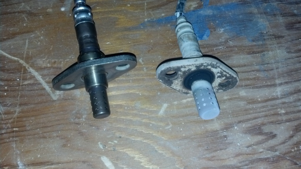

Well I put it in anyways. Here's a comparison
I don't really know if the old one was bad based on the little that I know but I figure the old one has been in there long enough. I think it's recommended to change them every 75K and I've got way more than that. I don't know if it's origional or not but hey, why not.
So I took it for a test drive and noticed not much. I did find something though. I played around some more with torque app for my android and thought I'd try to get as much info regarding o2 sensors as possible. I guess I should have done a before and after but I didn't think of it soon enough before and I didn't want to take it out and get the exhaust pipe hot.
So here's what I found. Fuel trim bank 1 sensor 1 fluctuated plus or minus 3%. Bank 1 sensor 2 was at 99% constantly. I had no idea what fuel trim was so I did a little bit of research and I guess that I'm running way too rich. I know there are a lot of things that can cause that. My first question is what does sensor 2 cover? Is it one half of the cylinders, or would it be the rear o2 sensor (which does nothing to air/fuel), or something else? Searching hasn't yielded much.
I'm not going to do anything tonight but I thought I'd share and maybe get some ideas. Thanks everybody for all the help. I really appreciate it.

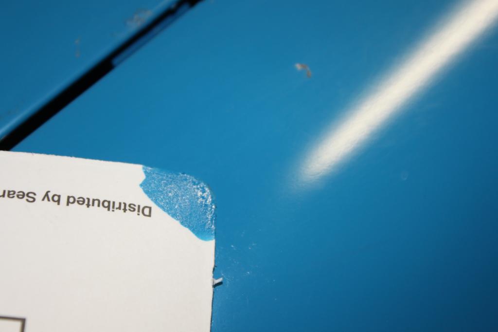

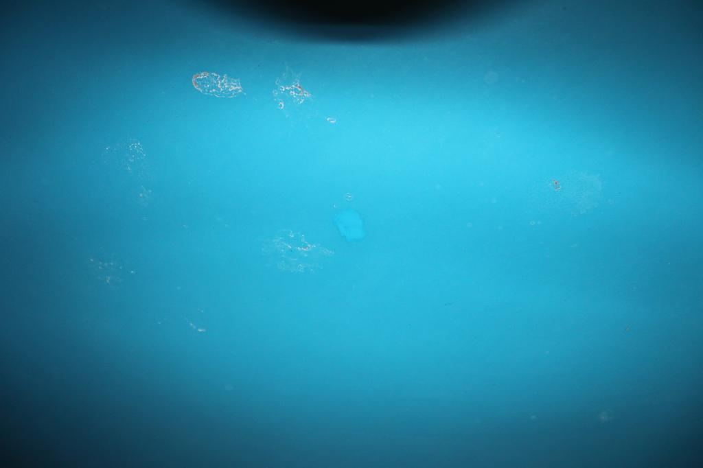

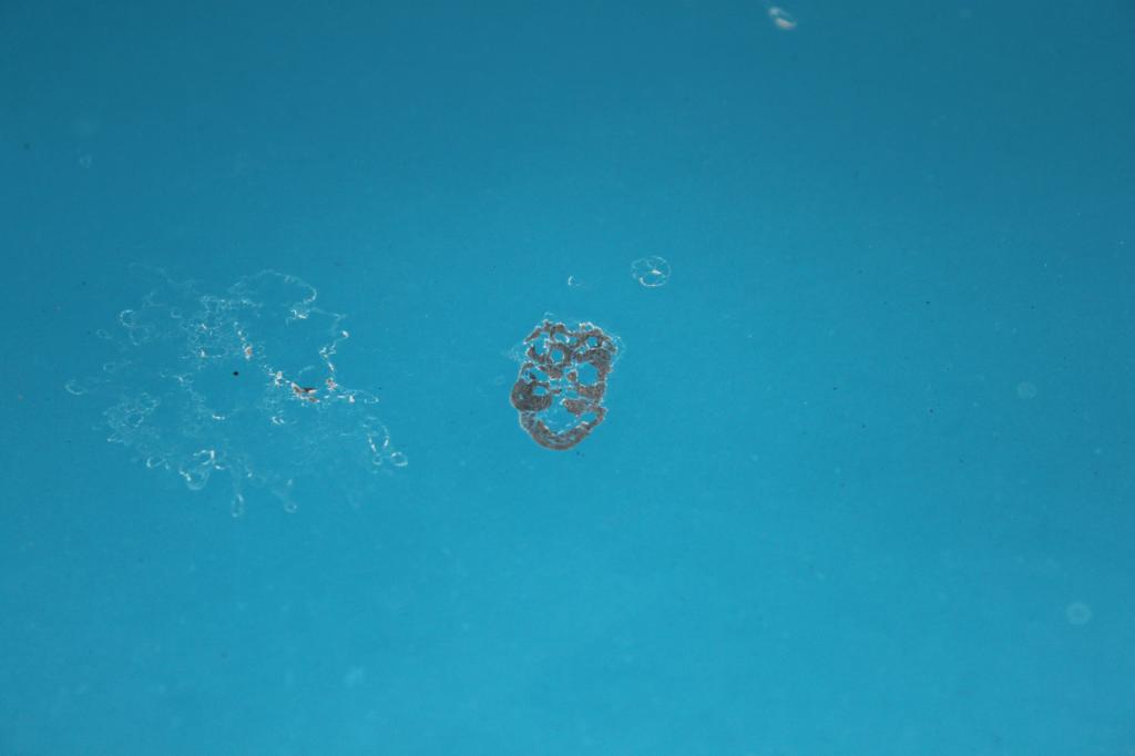

Well there hasn't been anything done here for quite a while. I guess that's a good thing and a bad thing. No major problems but no fun either. No camping and it way too hot to wheel out in the desert right now. Finally got around to putting in a new fuel filter. Good excuse to go buy some flare nut wrenches. Easy job so no pics.
I also gave the 4runner a bath. One of the things that I liked about the paint job when I bought it was how new and clean it looked. It's still ok but not very good quality. For example if a bird craps on it and I don't wash it off in a day or so it starts to eat away at the paint. Here is an example:
The spot on the left was probably 2 or 3 days. The spot on the right was a week or two. It's not always easy to catch them on the roof. I don't want to put a lot of money into this paint job, I'd rather use it for other stuff or a different paint job, but I got an idea. My wife has some nail polish that was pretty close:
So I thought what the heck I'll try it out. It's just the roof and it'll keep bare metal covered.
So what do you guys think? At this point I think it's better than nothing. I also thought about going to a body shop and seeing if they could mix me a little bit of paint. I don't know. Maybe I'll see how the nail polish holds up and use it for the roof.

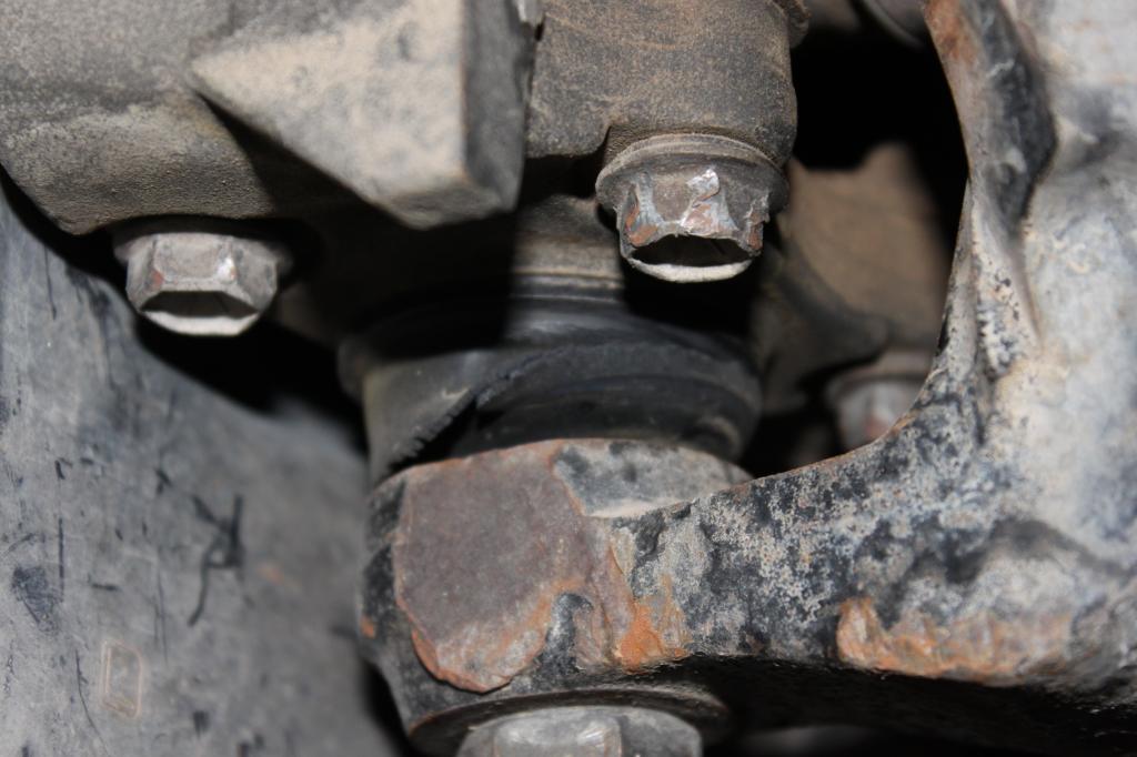

Last update. Anyone want to guess why this picture really bugs me?

Hmmm, couldn't be the boot so it must be the rounded bolts.
4 Lower ball joint bolts 59 ft lb and loctite
ball joint bolt 105 ft lb
Pick up a set of bolts too, when/if you get a ball joint.
