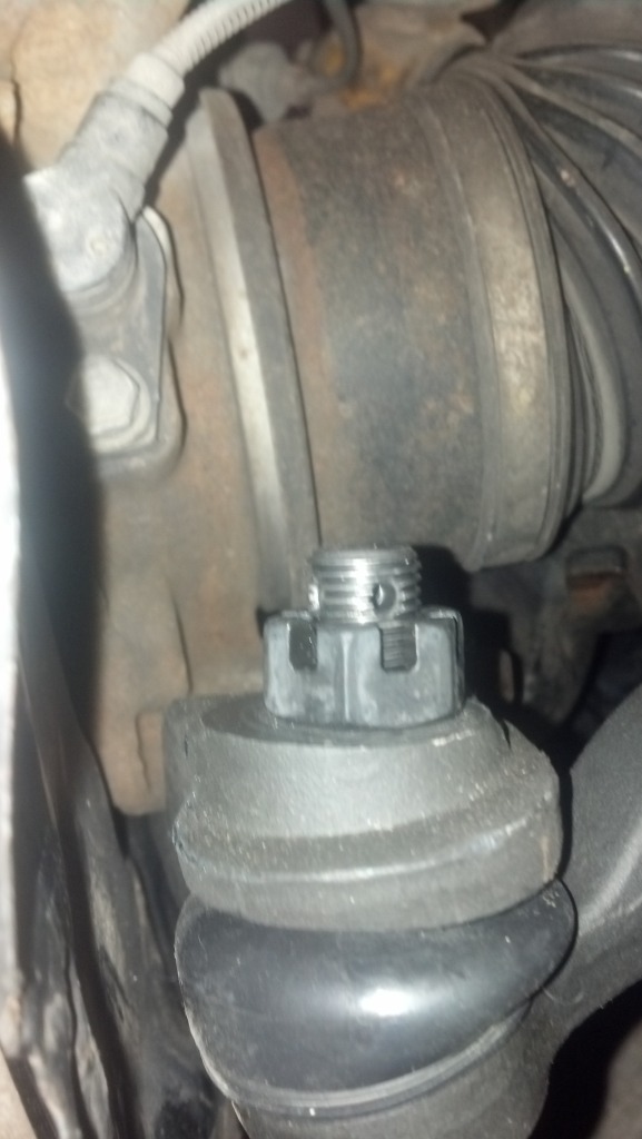

So do you thing that OTE is still good? I don't think the stud was turning, just that it never got tight. If the nut is tightened down to where the boot is the hole in the stud for the cotter pin is way above the castle nut, rendering it useless. I don't know if that's a defect or what but not knowing more about them I thought a new one would be best (especially if it's warranteed)

Yeah, the tie-rod should be fine. Sometimes they're a real pain to get tight, the ball just spins and the nut won't tighten. You aren't losing it any more than I was the first time it happened to me.

So when the nut gets tight do I just drill another hole for the cotter pin? Seems fishy to me.

Something is not rite with that end buddy.

Well I went and got another tie rod end today. Same issue
This picture shows the problem a little better, except this nut got tight and is properly torqued:
So I took some measurements and this is what I found.
At first I thought maybe the ball joint mounting plate was thinner on the new ball joint than the old. And it was! But not significantly. The old was 18.41mm and the new was 17.98mm. Less than half a mil. Stumped.
Then I wondered about where the hole was drilled in the stud. So I measured from the bottom of the hole to the surface of the tie rod end. Old 40.32mm. New 48.41mm. With the hole being less than 8 mils in diameter I successfully located the problem.
At this point I'm tempted to put 8mm of washers in between or drill a new hole, but I'm going to find the right part.
Since this is the last one the parts store had, I won't be getting another one from them. I guess I need to call around and see who has them in stock and take my calipers with me. Stupid almost correct parts. [/rant]

Ooooh, that's no good. I didn't see the cotter pin hanging out up in the air like that. I thought you were just having trouble with the nut not tightening down. I used Toyota outer tie rod ends because with my discount they were close enough in price. No problem with the nut vs. cotter pin with them.

Well there are no more left outer tie rod ends withing 60 miles of my zip code. Ha. Oh well.
I got fed up with parts stores and ordered a new one from the dealership. More money but worth it for the fact it will get here and will work. No complaints there. Hopefully tomorrow night it'll be all done and ready for an alignment. Now I just need to go back and rent a puller and get the current one off and back to the ill fitting place from whence it came.

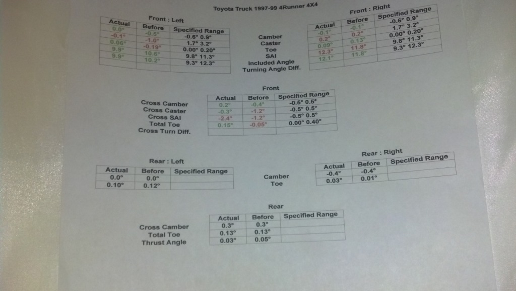

Success!... well sort of. I got an alignment today and they said they couldn't get the caster right. If pulls a little to the right on the freeway, around town it isn't really noticeable, but I only drove it home from the shop. The alignment is good for 3 years so I've got plenty of time to fix/replace whatever I need to.
On these rigs is castor adjusted with the lower cams? I didn't replace the control arm bushings on the passenger side. Then looked ok and the shop said they replaced them before I bought it (12K miles ago), but I have no paperwork or proof of that.
I know the truck was in a collision on the front passenger's side before I got it so I guess something could be bent.
It was dark when it came back from the shop so when I get some time and it's light outside I need to go check where the cams are set and take some measurements to see whats straight or not straight.
Anyways here's the numbers
As far as driving goes I'm very happy with the difference. There are no more squeaks going over bumps and no clanking felt in the steering wheel. That nasty rusty inner tie rod end was probably the culprit for the clanking.

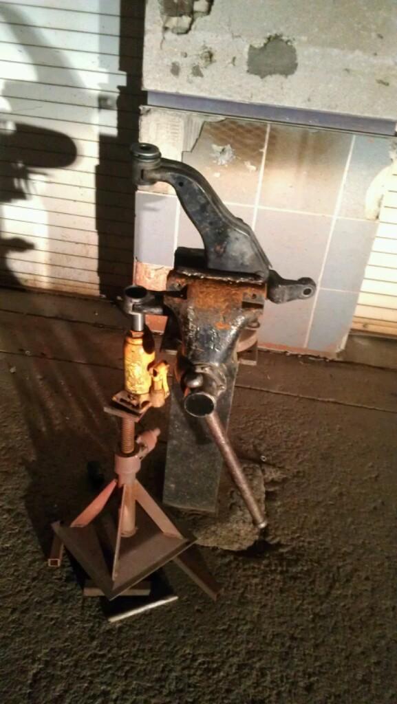

Oh almost forgot. Here's our very jerry rigged stuck in backwards control arm busing press (the word press here is used very loosely)
That's the proper use of those tools, right Jason?

Glad you got it back on the road. The pull has to be aggravating after all that work but I'm sure you will get it sorted our. My opinion of proper use of tools is if they work to get the job done, my old shop teacher would freak if he were to see some of the things I do lol.

Wouldn't it be great to be able to afford every 'proper' tool you wanted?
Then again, you wouldn't get to do any head scratching. Boring!
Good work, unwork, work, unwork, work, unwork, work, unwork, work!

I hadn't thought about tires. That makes total sense. I was really tired last night. They are worn really bad on the inside, because of all the worn stuff I replaced.
I've got new tires that are going on this weekend and we'll see if that helps, but I'd still like to get this caster problem figured out. Just my mild ocd.
More head scratching time...
