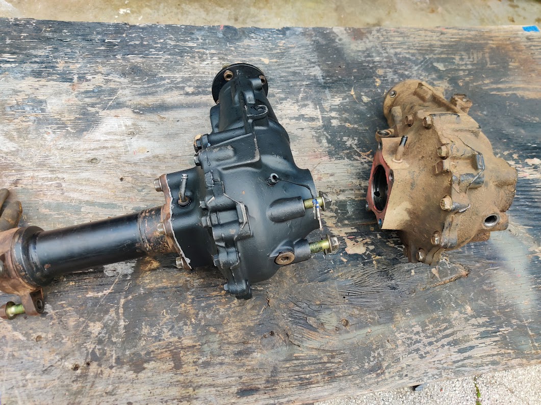

Did a little work on the new front diff. Stripepd down the old diff (the original 4.10 ratio) and got it ready to box up and send back to ECGS for the core charge. And boxed up my old slightly whiny 4.10 e-locker diff for a core return as well.
And put the non-ADD passenger leg onto the new 4.88 locker front diff.

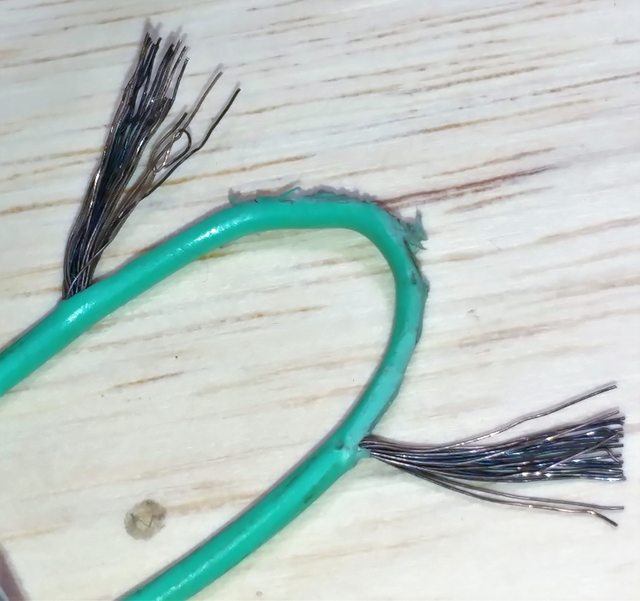

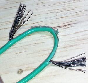

There was a little e-locker trouble once Mr. Moka got the rear buttoned up- it wouldn't do anything. Nada. He even tried the spare e-locker, still nothing. I couldn't get them to work on my e-locker harness either, but the unit in the 96 would lock/unlock.
Next he tried directly using the battery, both of the e-lockers worked. When we pulled the spare we also took the e-locker harness with it, so he tried swapping this harness for the 99's. Success!
I've been suspecting something is up with the '96s e-locker harness since our CO/UT trip, when I had intermittent troubles getting it to work but couldn't find anything wrong with the motor itself.
Having known working e-lockers not work when plugged into my harness, but then work when plugged into mine (different wire position) kinda points to a problem with my harness.
Today I peeled the coating off the 99's harness after finding no continuity end to end for one of the power wires. After I got the coating off I probed along the wire until I lost continuity and peeled the insulation there to see what I could see.
AHA! Nearly half-way between connectors, under the stiff sheathing, the wires were discolored and broken. I'm betting I'll find something similar on the 96's harness too...but still together enough to work in certain positions.

Yeah, that was some frustrating timing on the harness failure. The locker has been working flawlessly forever. It worked normally immediately before I pulled the 4.30 diff, because I locked it before removal (makes it easier to pull the 3rd member out of the axle housing).
I never *yanked* on the harness, but I did gently dangle the actuator from it after removing it, before undoing the connectors. And then did the same on reassembly, connected it before putting the actuator on, then lifting the actuator up. Before discovering the actuator was 100% dead.
Obviously, it flexes every time the axle moves, and 24 years is a good run, no complaints. And it was probably considerably weakened and all it too to completely fail was being straightened out.
Glad we happened to have a junkyard spare harness. But it's around 20 years old as well. We might need to get a couple of new ones. Toyota still makes them...
