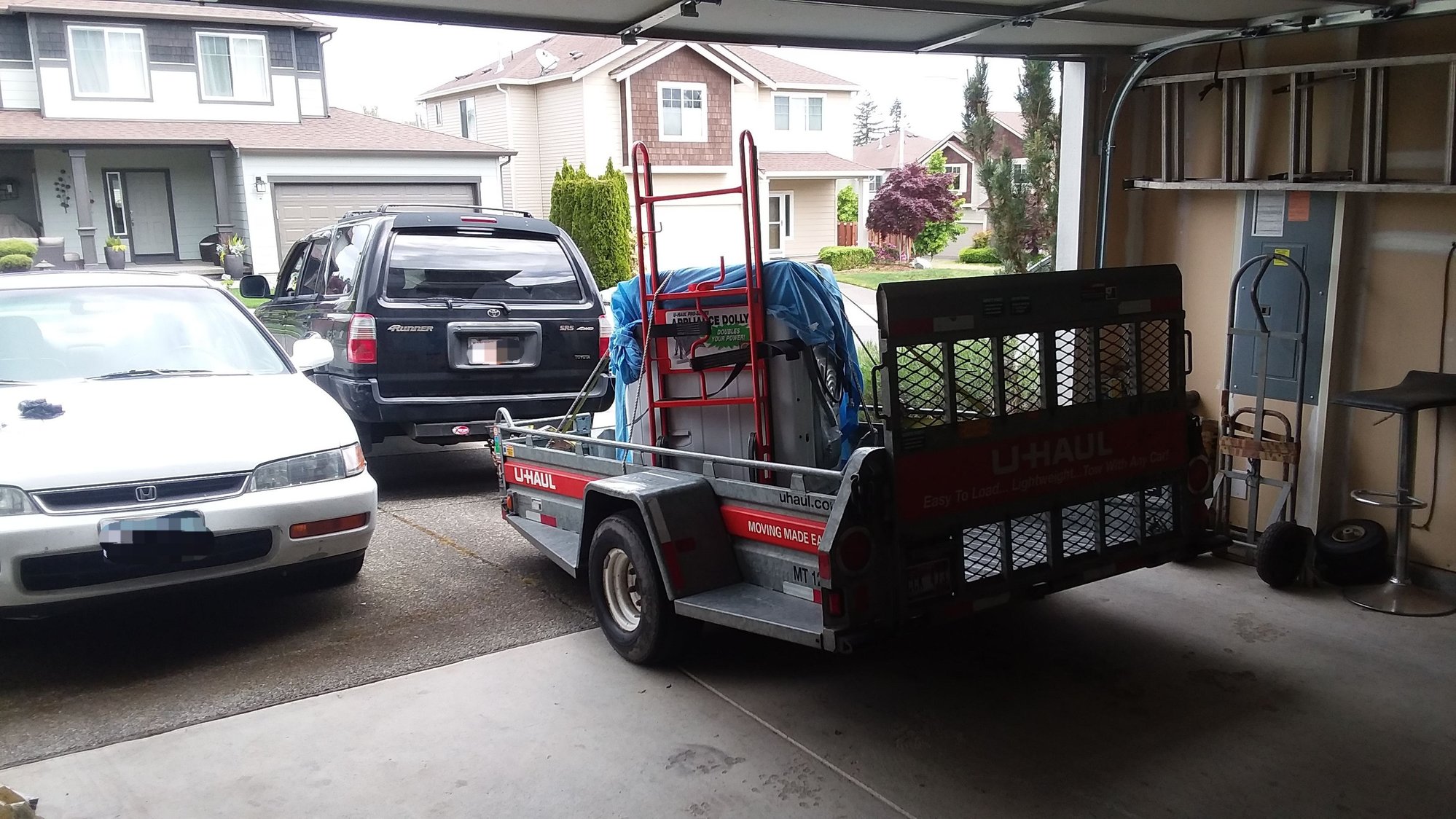

I swear that moonroof drain is next...I came to visit to check if I had posted a picture of towing a utility trailer but it looks like I didnt. So while I'm here, a few things I did:

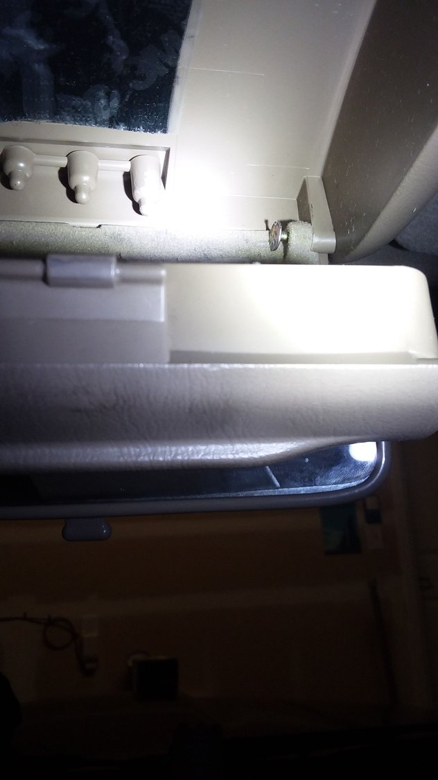

-took a nail sitting around and managed to fix my loosely hanging upper thingie for sunglasses/garage remote

Did I mention I like using U-Haul?? 🤪

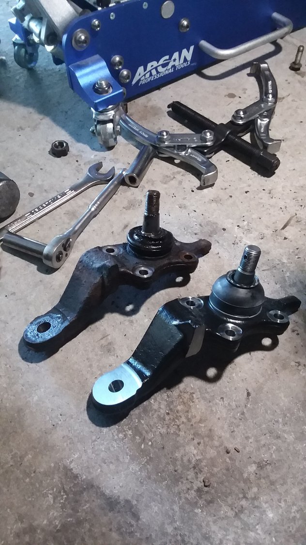

Moonroof drains clear, lower ball joints changed
So I checked the drains the other day by running fluid down and they went right through to the ground. I imagine if it had been clogged, I'd gotten little to no flow. Seems likely the sealant, if there was any, between the moonroof glass and the plastic trim molding or the rubber molding itself just wore and tore. To be continued...

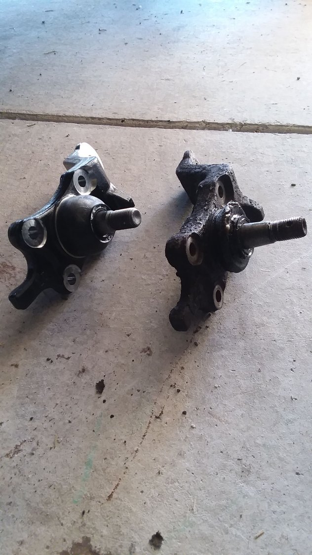

Then took the chance today and last night to do both lower ball joints. I got lucky with my adjustable 2 jaw puller from over 10 yrs ago with the pass side. The driver side tie rod gave me headache and after that experience, just gonna get the actual tie rod puller tool to save time at work. Fun job though since not on the clock.
Bought the joints few years ago, glad those are in once the old ones put out some grease.
Wish it were that easy. Certain instructions left out so much detail.
Driver side condition was worse. Again, no video of the popping action. I suck.

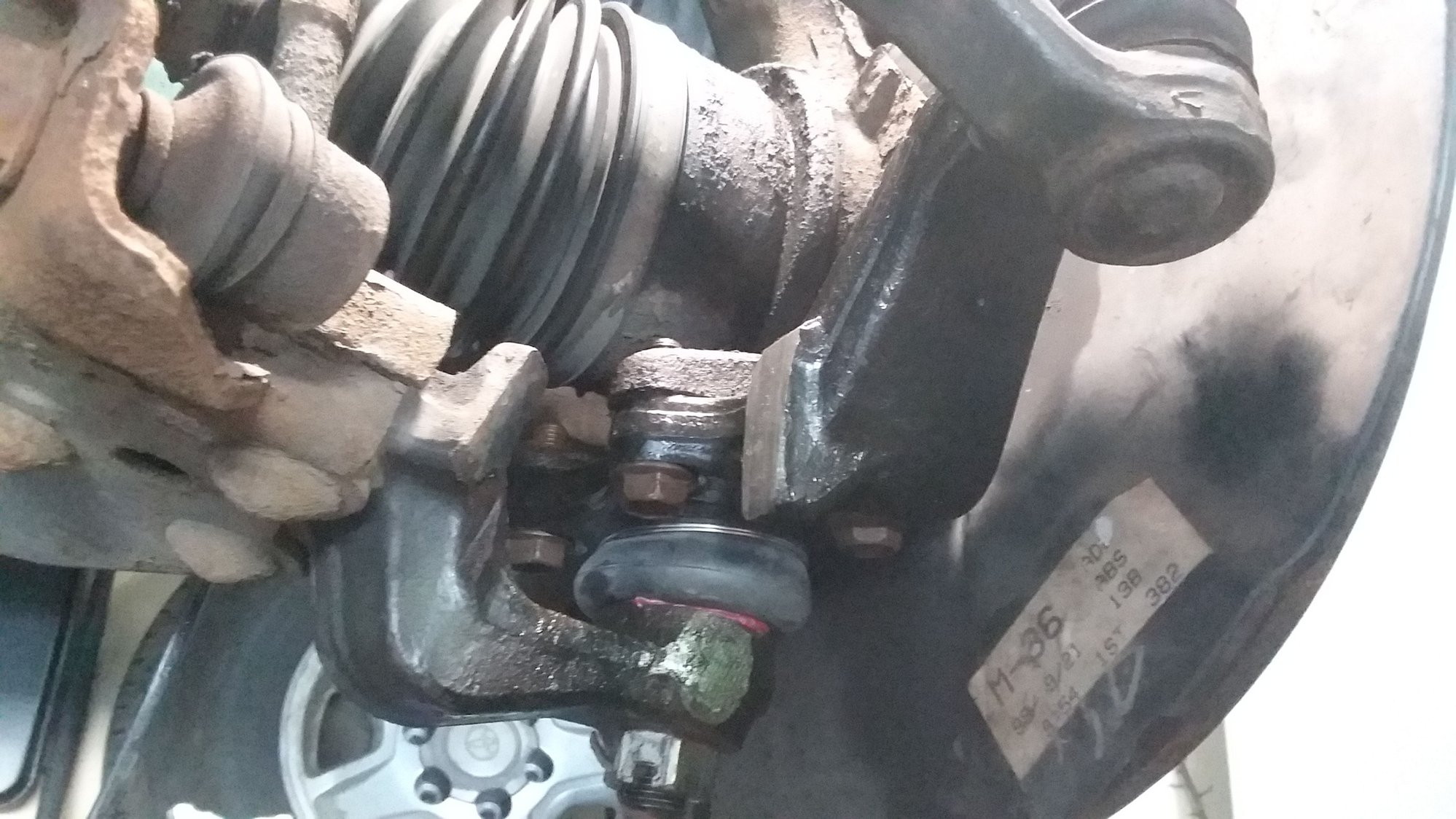

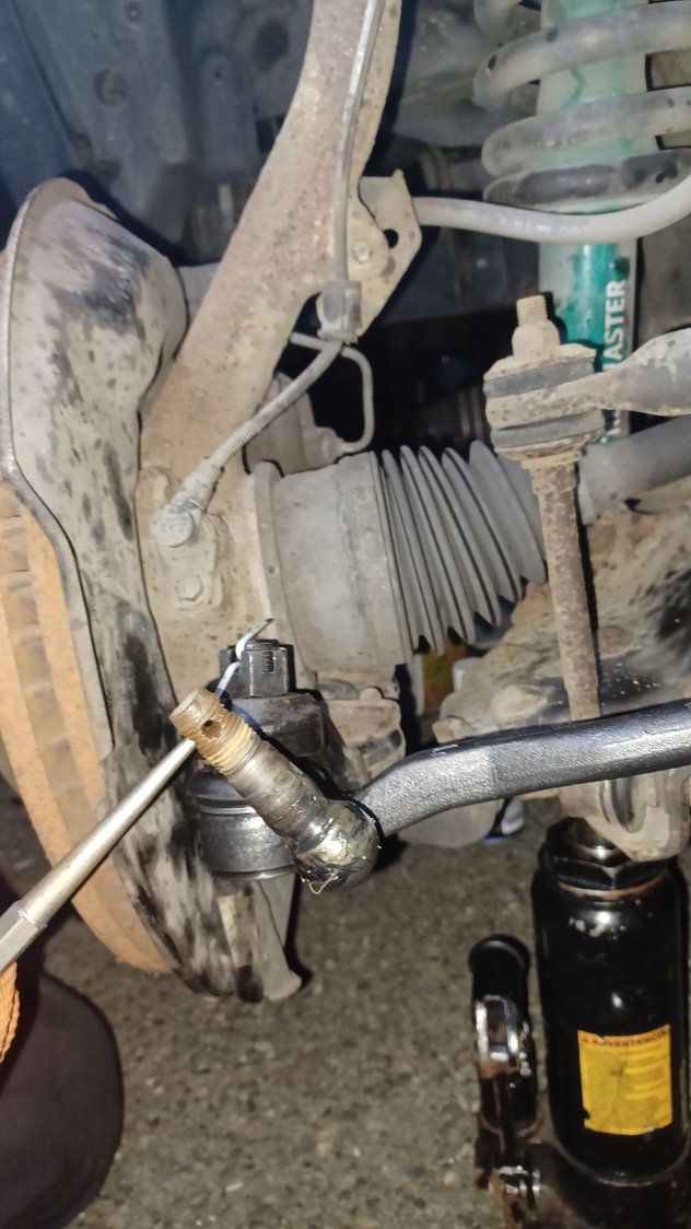

Ball joint removal notes
Few other shots:
Better one showing the grease seepage. After the loud popping noise of freedom. The one time I didnt press record on the phone.

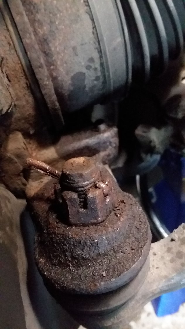

Loosen/tighten to break free (cotter pin). Makes a world of difference that I should've done long ago with fasteners in general.
Started wiggling out enough for the cutting pliers
All that just to remove a cotter pin. Thankfully cotter pins are cheap.
Unfortunately no shots of the ball joint mounting bolts. Removing them came close to shearing due to buildup of rust on the threads (wire brushed off before reinstall). And since the new joints came with only new castle nuts, I had to be careful not to break off any since I needed this 4rnr for the job tomorrow. So I used applications of penetrant, MAPP torching, a touch of hammering and slow torque on the breaker bar to coax those bad boys out with no issue. Despite the flammable warnings, the fact is the penetrant sprays are nothing like putting flame on the spray can itself. Of course with the rubber components, I had to steer clear of bbq'n. So I no longer hesitate with using both methods on stubborn fasteners. I've had enough of breaking crap on me with too much torque and then have more complications and wait time thrown in.
I will say, on using the large adjustable puller, it is NOT easy to set up. I need almost a 3rd hand to grow out of my body to turn the threaded head. But once its aligned and set in, it does its job. Bit of a trial and error with a few times it just snapped off unsuccessfully so I use my other limbs and tools to help hold it as the tension builds with each turn. Do not hold fingers near that(!) It hurts.
The two jacks weren't just for safety. But also for freeing up the vehicle's sprung weight off the ball joint, while another helped support the upper control arm from weighing down on the cv axle with the lower portion of the joint assembly disconnected.
Not bad for hand tools and then some.

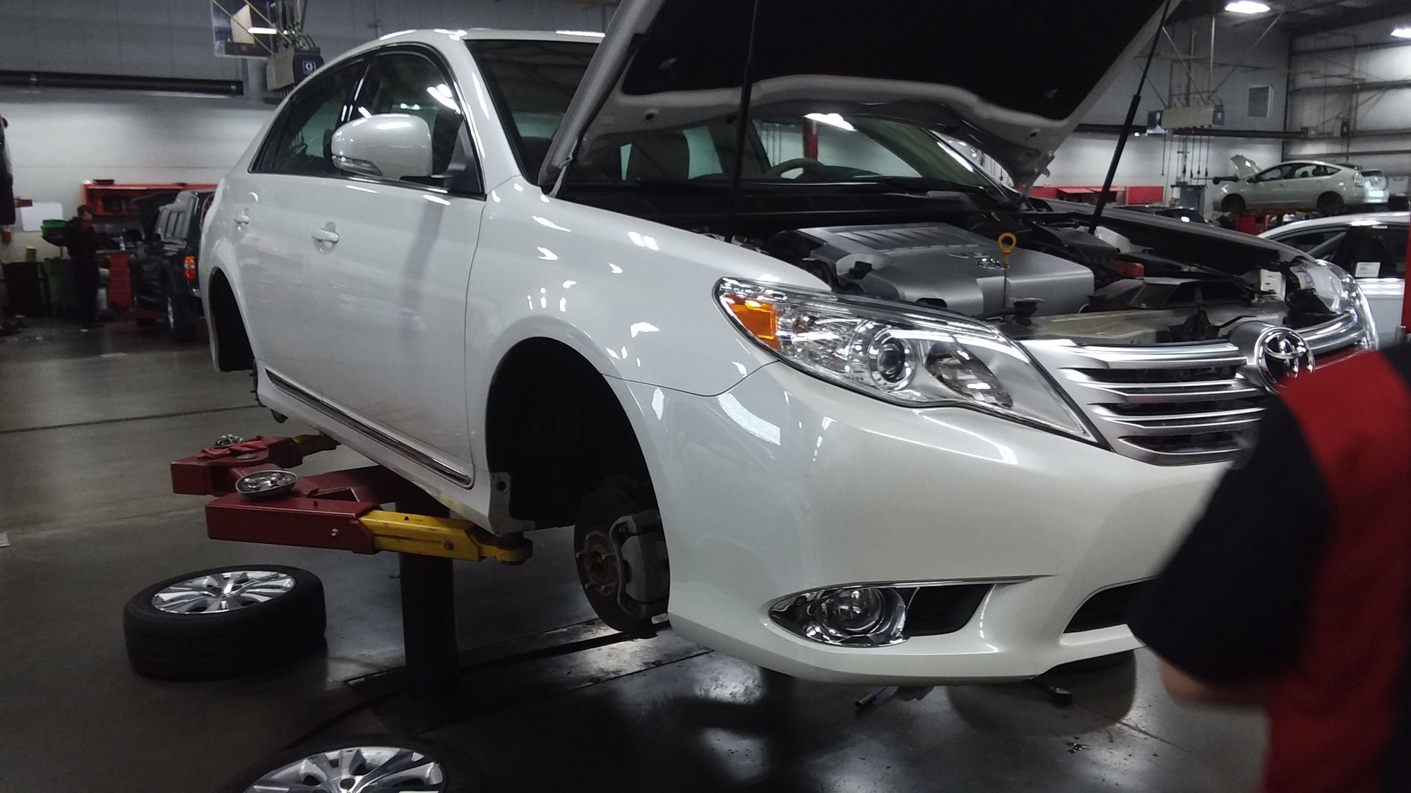

Convinced the wife to join the Toyota family
Oh and last fall, the mrs and I decided to look for a reliable car for her while I fix the Honda and lo and behold we found ourselves loving the 2011 Avalon(!) She did mention wanting to drive the newer model 4runners. But for the fuel economy and roomy interior, that 3.5l engine is even slightly bigger than the old 3.4 5vz!
I took some time one afternoon to get the maintenance done for her new ride. Oh and sweet history - 2 previous owners, clean carfax, and only 28k miles. Just a bad battery from sitting around. I was like, "give me that! I know what to do with it!"

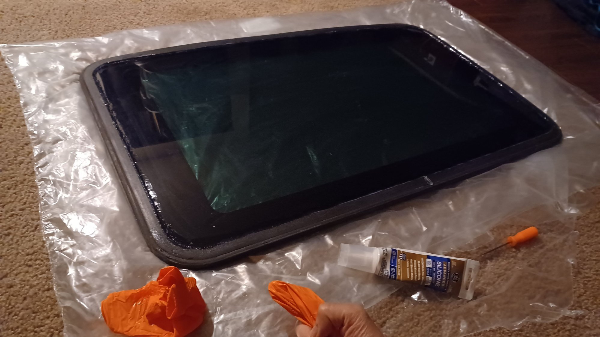

Fixed sunroof leak
Sealed it earlier this year. What a relief. No more leaks for now.
