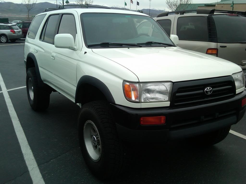

my son looked at the 4runner points and says snow, so now we have the "snow runner"
i picked this up a couple weeks ago , 1996 4runner, 3.4L, auto, SR5, E-locker, 2-3" lift, brand new 285/75R16 tires, and brand new pearl white paint job.
cabelas parking lot an hour later and was already buying stuff for it lol, picked up some seatcovers and steering wheel cover out of the bargain cave.

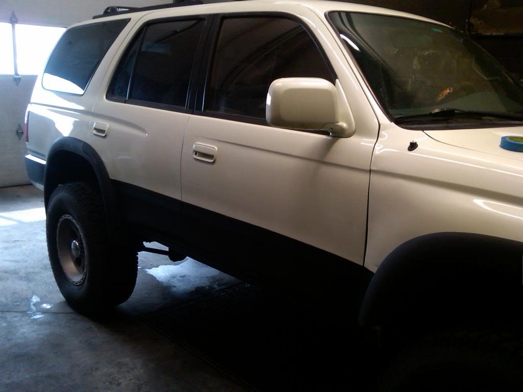

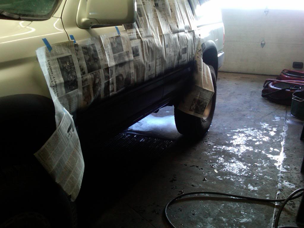

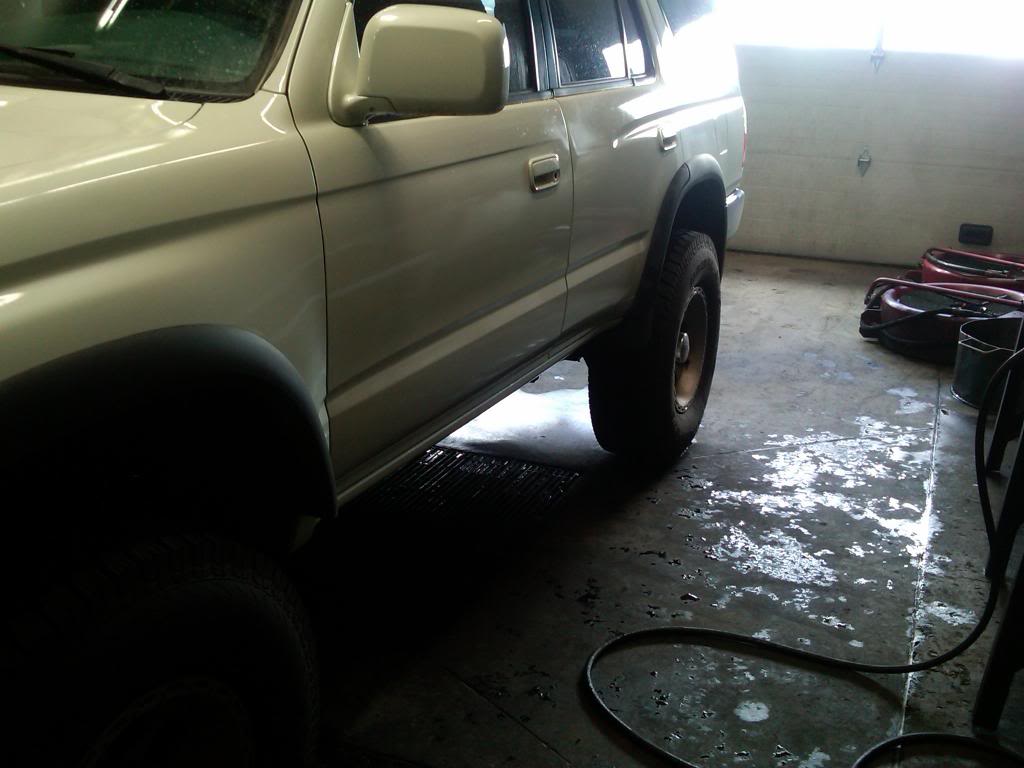

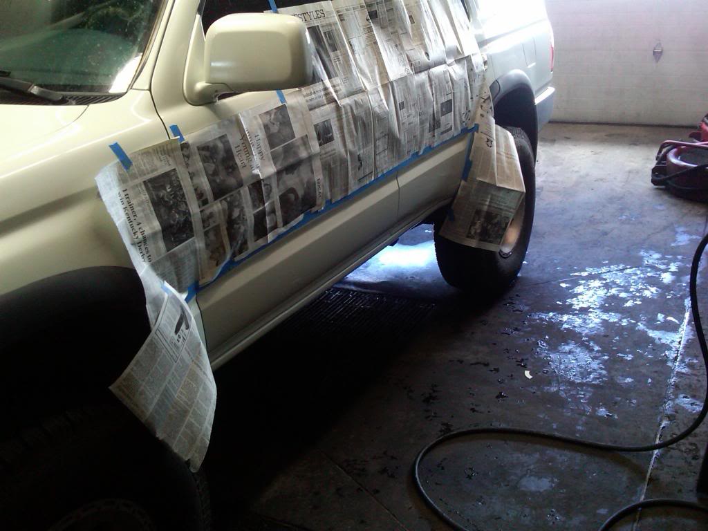

i have bedlined the rockers on several rigs of mine and used undercoating, i figured i would try plasti-dip this time. suppose to hold up good and when your tired of it you can just peel it off.
pulled it into the wash bay at work and got it all cleaned up
taped it all off
i learned one thing about it, when you get ready to pull the tape off, run a razor blade over it or it tries to pull off with it

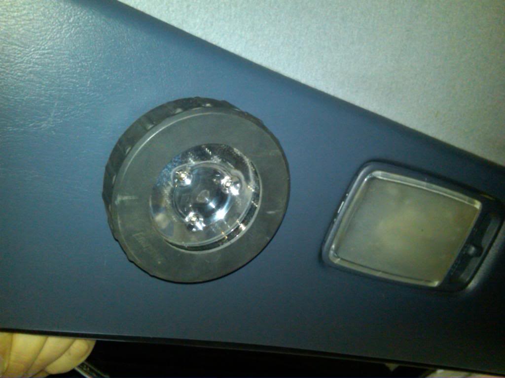

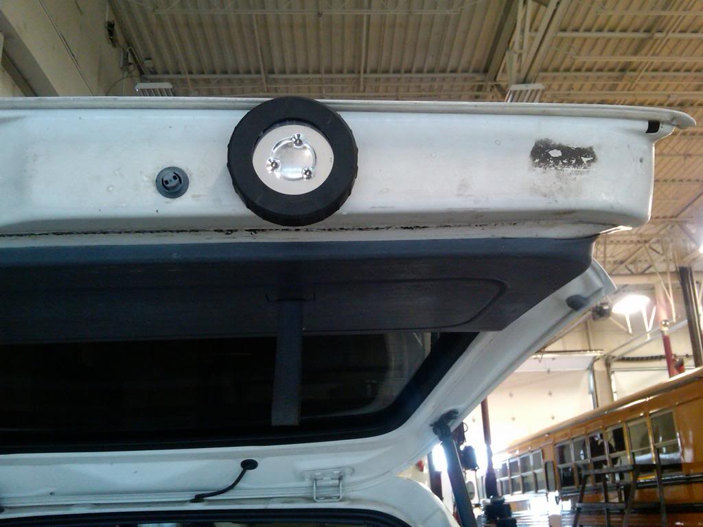

simple addition but one of my most used
its magnetic

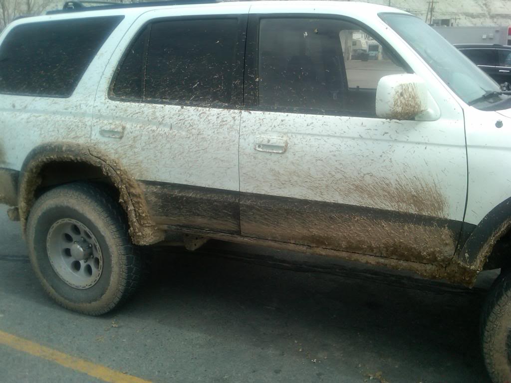

wasnt much for snow but there was some mud, this stuff was horrible to clean off. i also learned that while most people say you can pressure wash plasti-dip and it wont come off, dont try it with a 220 degree pressure washer. it all came off

Crazy the plasti-dip came off with a 220° pressure washer. What a major bummer!! I did my rocker panels with Herculiner in December of 2011 and it still looks good. I haven't tried the hot pressure washer but it's held up to a scrub brush really well. I never did apply the UV coat, and though it's not shiny/glossy, it hasn't faded in color. Still pretty much jet-black.

ya ive used bedliner and undercoat on the rockers before with no issue, i just figured i would give the plasti-dip a try. never tried it before.

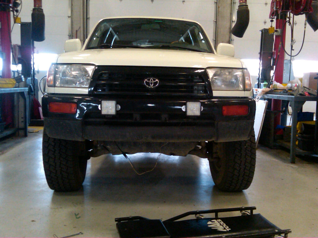

today i came back in and worked on some other projects for the runner. since i didnt have a roof rack to mount my lights too, i mounted 2 of the 4 on the front bumper since i wont be building my bumper till my dad brings my welder and plasma next month after the family reunion.
(i zip tied the wires up after the pic)
they are 15W five LED 60 degree flood pattern

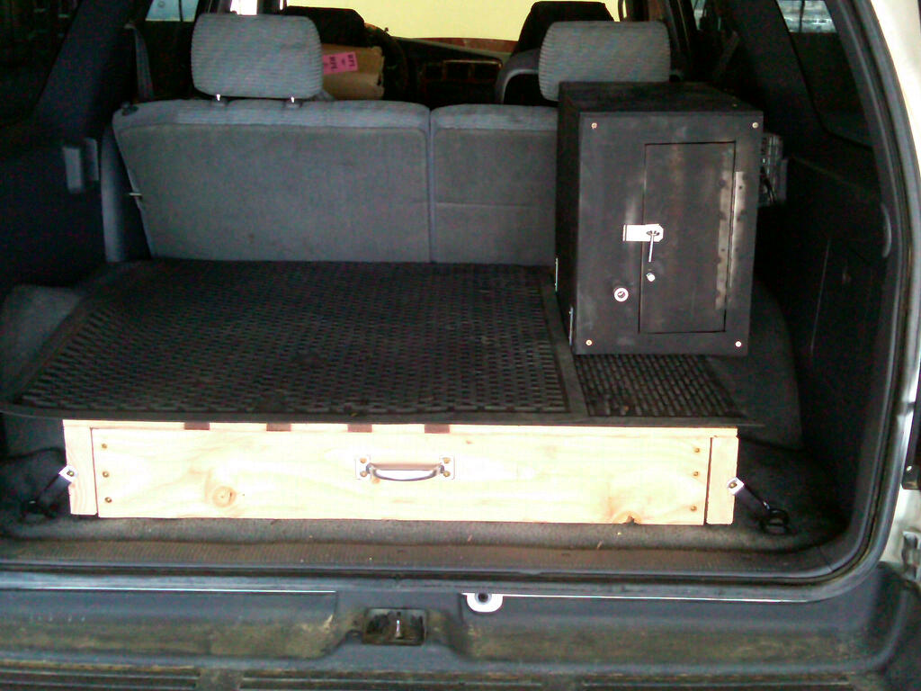

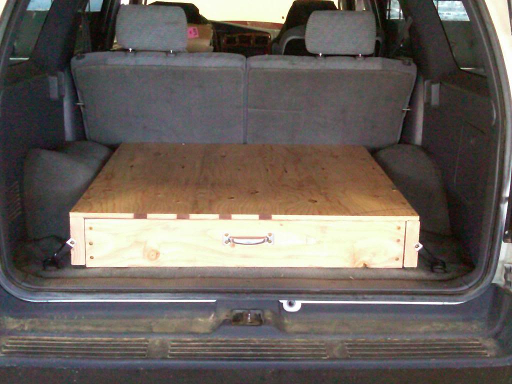

and i built a storage drawer version 1.0, nothing fancy no slides or anything, just friction. i didnt want to spend alot on it just to decide i didnt like having a drawer. later down the road ill see what happens. the black box was from my cherokee and has an air compressor with tank in itand the air chuck coming out the front. it is just a cheap compressor i picked up on clearance when i worked at o'reilly. i also mounted a new cobra power inverter onto the side of the box. the mat is just an old rubber floor mat we were going to get rid of at work, i cut it so one part stays under the air compressor box and we can pull the other half out and put it on the ground for my kid to stand on if we need to clean him off or anything like that.
dont pay attention to the faded paint on the box lol i painted it 2 or 3 years ago
