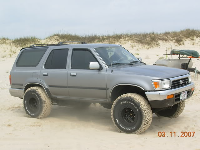

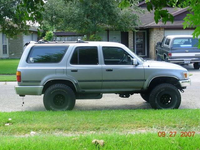

I run 32's on my 95 4runner. I've got 15" wheels with 2.5" backspacing, I got all four wheels for $75 if that helps explain the backspacing, and 2 1/4" daystar spacers. The only rubbing issues I've had were on the valance, but I wanted to rip it off anyways.
Before spring spacers

After spacers

question for you. i have a 93 4runner completely stock. i want it to look like your before picture. what size tires are those?

Originally Posted by ogee89
CC_yota
but if you have an idea that would be great.
33x10.50 and 32x11.50 both fit stock heights as long as you're running a 15x8 w/ 3.75 - 4.5" backspacing.
