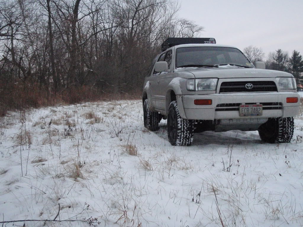

I won't have my 285's for a couple weeks but I have the 05+ taco wheels with spidertrax 1.25" wheel spacers. Here are a few pictures I have of my 4runner with this set up. If you want any other angles just let me know and I'll snap some more pictures tomorrow.
BTW these are the stock 265/70s

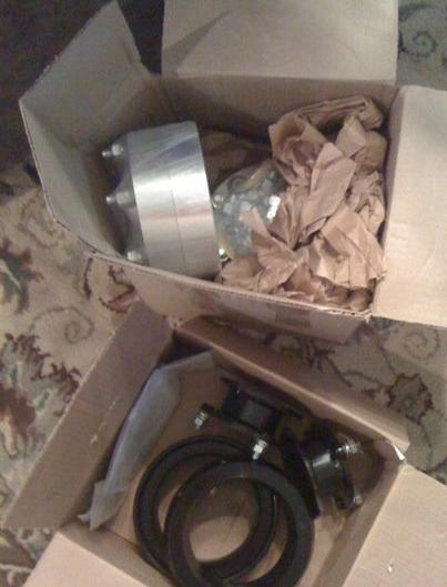

This may not be applicable to your year, make, and model but chances are it does. I ordered and installed a 3" lift and 1.5" wheel spacers so my 08 fj could take 285/70/17 tires on stock 07 Tacoma TRD Sport wheels. The result was perfect for backspacing clearance, but the lift is still a bit shy of keeping the tire from rubbing a protruding piece of inner fender, especially when turning in reverse. I'll likely go up an additional 3" later but the 1.5" wheel spacers were perfect for the purpose of getting good clearance from the upper A-arm. The tires don't stick way out past the fenders either. Hope this helps.
Attached Thumbnails wheel spacers w/ trd fj rims?-fj-spacers-lift.jpg

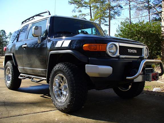

Yes Haddix, I agree with 4Runner114. You should be fine with your 1.25" spacers and 315's....assuming you're talking about the later model front IFS and your rims have a stock positive offset (+10mm if I remember right). If they are not stock, then you'll have to break out the tape measure and figure it out. With my 1.5" spacers and 285's, my hand had 1.5 to 2 inches of room to flop back and forth between the tire and the upper A-arm. Also to tweak my previous comment...When I said negative offset being an issue for the bearings, I meant HUGE negative offset. Up to -15mm is not unusual and not an amount to consider detrimental to your bearings. I have, since my last post, removed my Tacoma TRD Sport rims and 1.5" spacers from my FJ and replaced them with MOTO Metal MO951's that have a -12mm offset. This is very close to what the stock rim and spacer combo produced. The 285's stick out just ever-so-slightly past the flares and give a broader, muscled stance but still somewhat understated look.
Attached Thumbnails wheel spacers w/ trd fj rims?-p1050242.jpg
