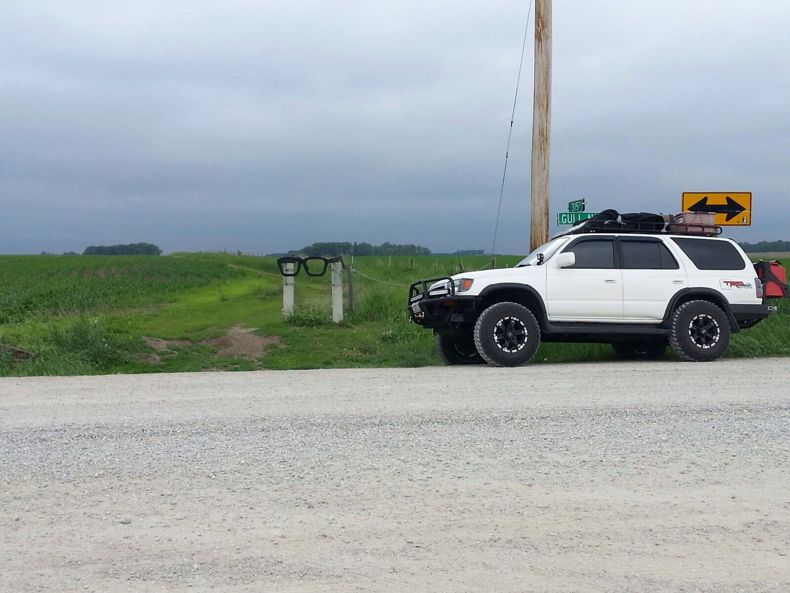

On first major vacation in the 4runner. When I put on the cbi rear bumper there was a little sag. Now that it's loaded up there is about a 4" drop. Out here in Wyoming it has bottomed out many times. Obviously I'm going to have to upgrade when I get back.
I figured there might be an offroad store in Utah that we could stop by on the way home. Will I need to upgrade springs along with the springs?? Any ideas on what to get?? I have sent 4cawler an email but have not heard back yet.
Thanks
