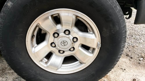

I am about to do the brake upgrade to my 1997 4runner and need to know if my rims will clear the 231mm or if I have to get the 199mm calipers. Also are the rotors from a Sequoia the same as the tundra?

No, those rims will not fit over the 231's. 3 choices: go with 199's, find some 5-star or flower rims (or 17" or aftermarket), or grind.... check out BigFishAllDay 's thread: http://www.toyota-4runner.org/3rd-ge...rs-rotors.html

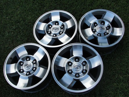

How about these wheels? Anybody have these wheels with 231mm calipers and if so are spacers needed to clear them?
Attachment 189437
I've got these exact same wheels, 16", 5-spoke, bought off of Craigslist to replace my badly curb- and salt-chundered stock 16" split-3 spokers. My understanding is that these rims came off of FJ's, but maybe these are LC's after all, based on the info in Terminator's post following the one quoted? I'm trying to figure out whether I need to buy spacers for these or not in order to clear the 231mm Tundra calipers (I just cannot get behind the notion of hand-grinding the backs of wheels, for a number of reasons not least of which is a bad experience in the past doing that). I could have sworn in one thread or another somewhere (threads, threads, everywhere a thread, cloggin' up the scenery, breakin' my mind... they all blur together after a while LOL) that someone said that all FJ wheels, 16" included, clear the 231mm calipers because the FJ's only used the 231's. Whether this is true or not, I don't know, and I can't find the post I saw (or THINK I saw) it in. So it's a 2-part question - are these in fact FJ or LC rims, and if they are 16" FJ rims, will they clear the 231's without mods/spacers?
