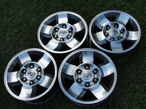

Can anybody confirm that these wheels fit the 231 calipers with no modifications/spacers?

Old Aug 11, 2012 | 05:11 AM
  #27
BigFishAllDay's Avatar
Joined: Jun 2010
Posts: 75
From: USA
I can confirm 100% that those wheels clear the 231's with room to spare... no spacers, no modifications.
I put a set of 231's on my Wife's 2000 4Runner this week, and had those wheels installed w/some new tires. There's a ton of room between the wheels and the calipers.

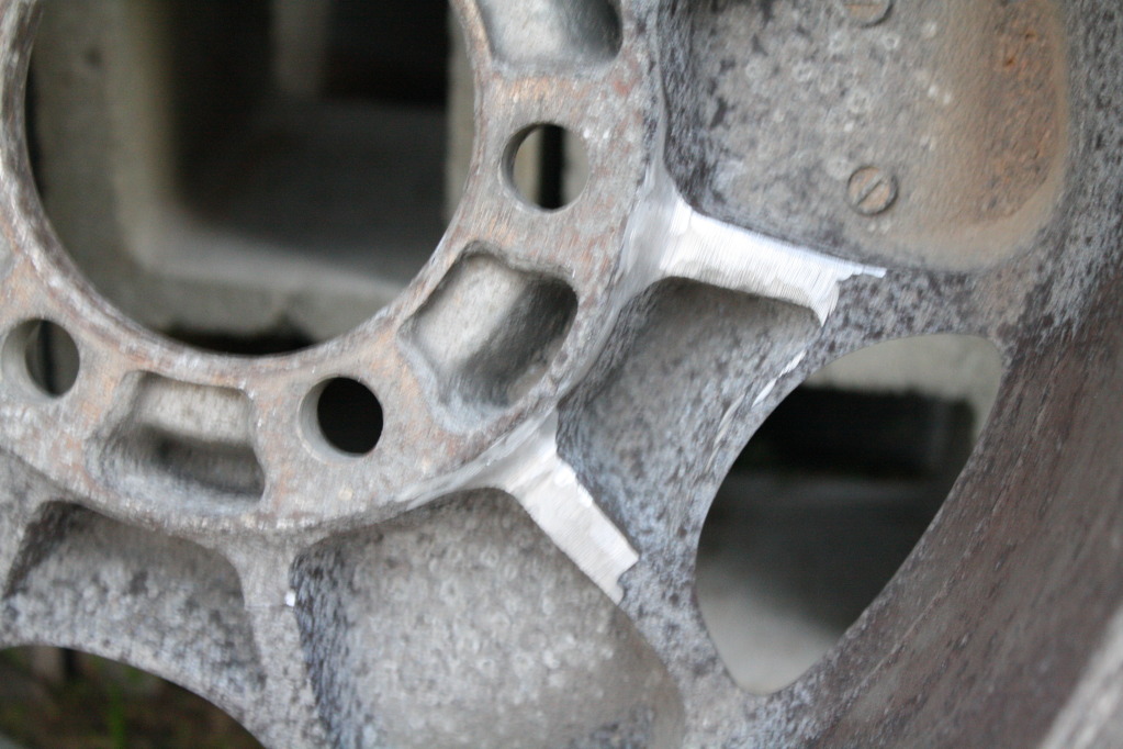

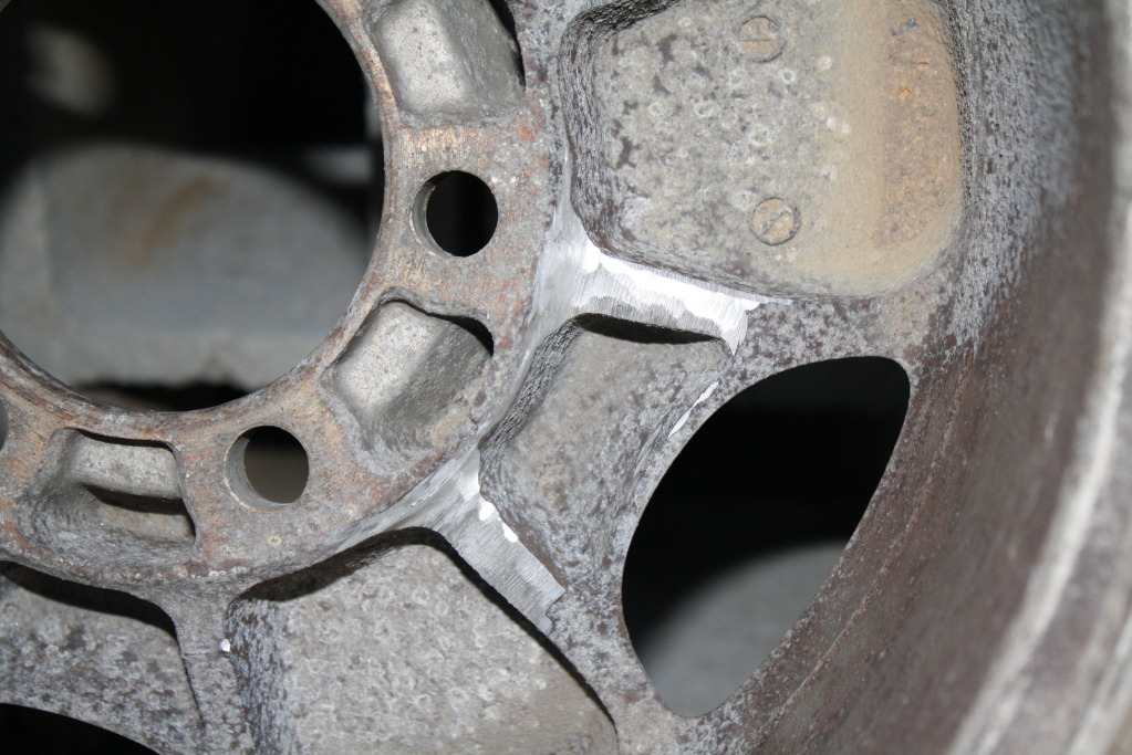

LC80 wheels will fit, with some work
OK, so I finally had a chance to start grinding on my spare LC80 wheel. I was wanting to see if I could clearance them enough and it worked. I ground off probably 2/8-3/8 of the wheel to fit. It's very close but it worked out very well and I'm going to finish grinding so I can remove the 1" wheel spacers I have. The 1" pushed out the wheel far enough that I'll rub when pulling out of my driveway when I drop off the curb and when pulling in while turning.
So for all of you guys with LC80 wheels you can clearance them to fit the 231mm calipers. Similar grinding like on the split 3 spoke wheels but it will fit.
