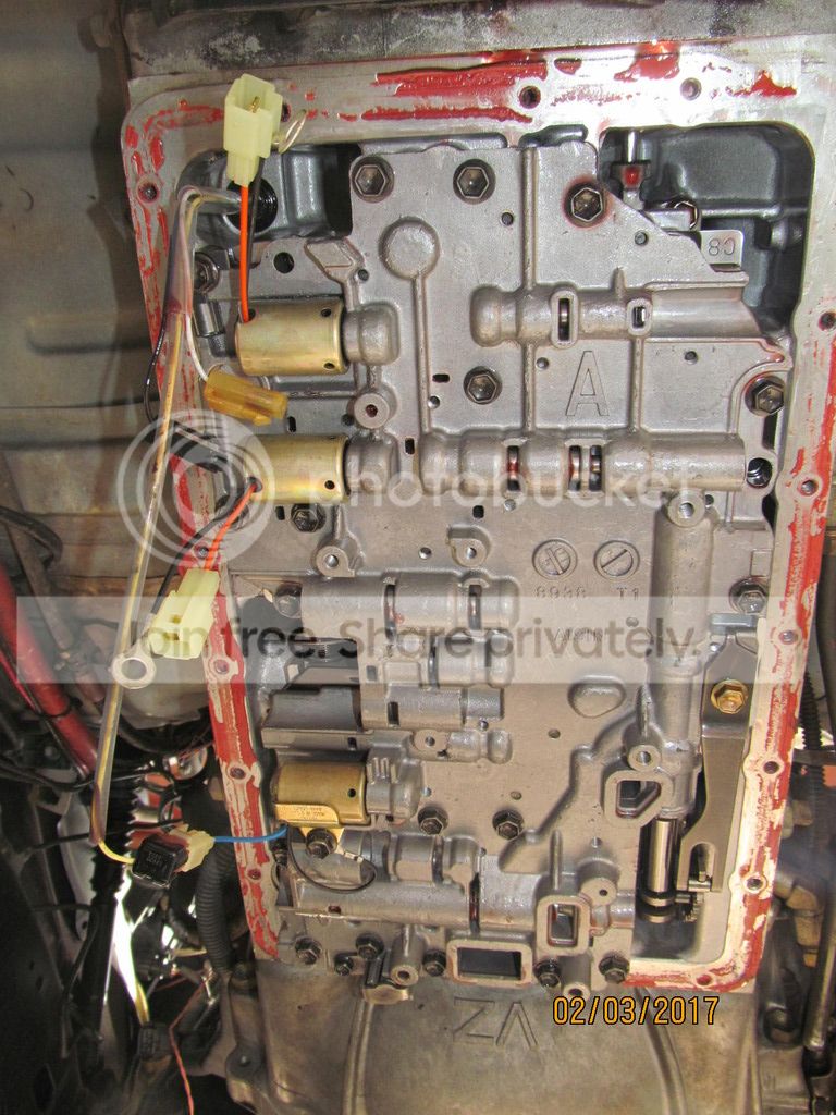

See the 2 shift solenoids? one has a white wire and one is black.
And towards the front of the tranny is the lock-up(yellow wire).

I drained most of the fluid and dropped the pan.
The fluid was in really good shape but still going to replace the filter shown.

The filter is removed....comes off easy with four 10mm bolts. Another 1/2 cup will come out.
Much better view without the filter.
3 bolts holds 2 solenoids. With the filter in place you cannot get this bolt out.
I think it's 8mm.
Lockup solenoid.
I think it's 8mm.
Lockup solenoid.

The 3 solenoids plugged right in....the long yellow wire one is the lockup.
the white wire is the 1st solenoid.
Black wire is #2.
The supplied bracket worked nice....3 bolts holds it in place.
The routing of the red wires....who cares.
Another angle of the 2 solenoids.
Last but not least is the lockup.
The bracket fit nicely.
The yellow wire does not really tuck in much.....
so I'm gonna let it hang. No reason not to.
Plenty of room in the pan.
Black wire is #2.

hmmmm.....wonder if I can dis-able the OD lockup function to see if that is the source of the "heat".
So, after researching a little, it looks like if I clip pin 7 for the SL solenoid that I will be able to use
4th gear without the "lock-up" circuit active. That will tell me a ton of info if I drive on the highway
in 4th and the temps do not increase any more than they would in 3rd gear (presently around
144 degrees in 3rd). If the temps stay low then the TCC clutchpack is the prob.
By the way, if I already didn't mention it, putting in the 3 solenoids was basically a 1 banana operation.
I used no rtv with the supplied rubber gasket in the tranny filter kit and not a leak at all.
