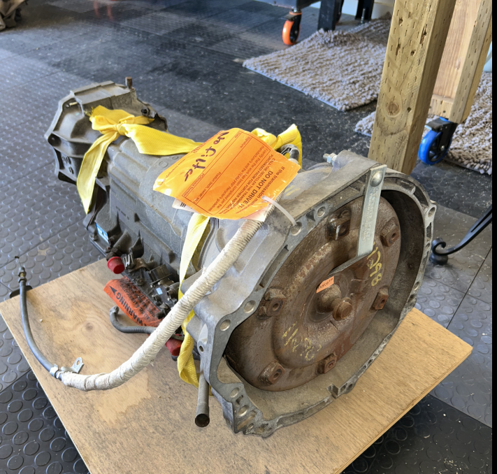

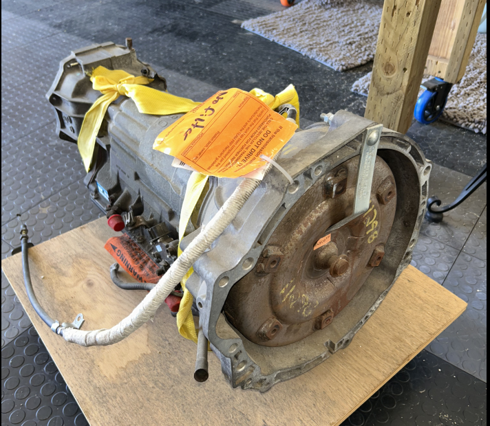

I found a place here in the Phoenix area for a TC, just got one for me 90 5vz swapped auto (a340H) pickup. They give a 4 year or 100k mile warranty! I also had the P0770
https://www.transtar1.com/

Well thanks for that Phx location......I'll bookmark it! Might have to check them out. I'm in Prescott now but that's only 2 hours away. So I guess you had the 0770 code and the new TC fixed it up just fine.
