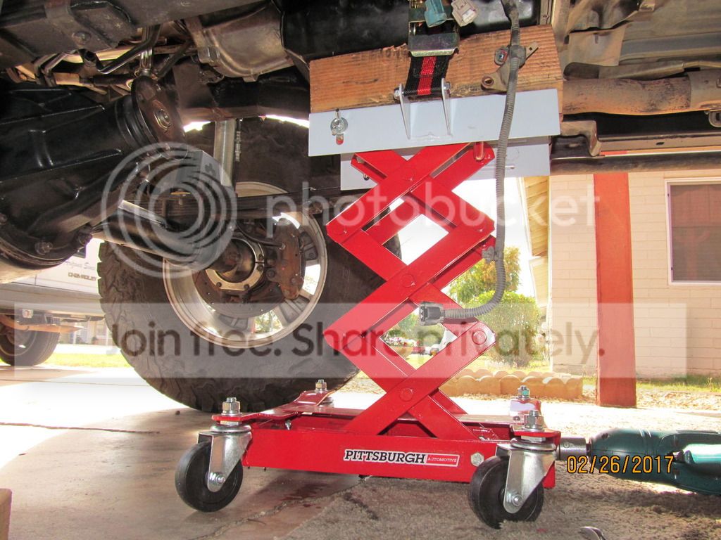

Rear driveshaft out of the way.....Splines were marked, of course, so that the same exact splines are re-engaged upon assembly.
the gear handle assembly next....something like 8 little 10mm bolts and ip jiggles out.
Front driveshaft out of the way, Remove the 8 bolts that hold the transfer case to the tranny and
slip it off. Those 2 top bolts took just the right 12mm short socket with a flex extension....
Here they are. FYI the transfercase as is here weighs 72.0 pounds.
Almost to the point of seeing that torque converter.....

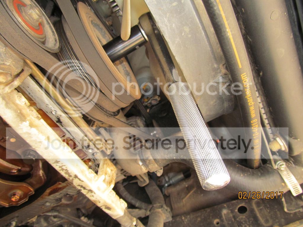

The 2 top bolts that couple the bell housing to the engine block were interesting to get to....you can see the 1 bolt up high(17mm)on the driver side of the bell housing.
I used a 33" extension and they came off like butter....

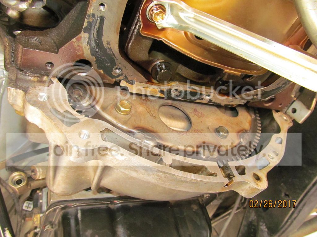

The 6 cute little 14mm bolts that hold the TC to the flexplate were easy.
I saw it in the FSM that you just turn the crank a little bit and you can get those 6 bolts off.
But I found that un-necessary....just used the 14mm wrench to turn the flex plate and re-positioned the wrench in such a way that the bolts loosened up.

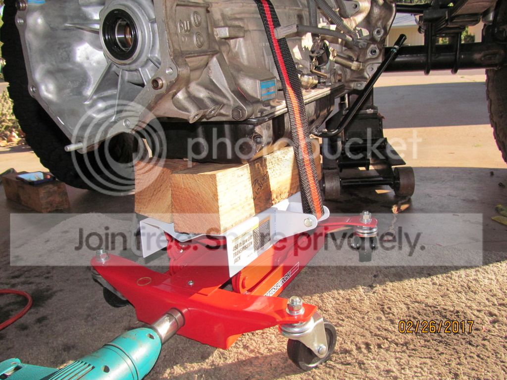

And the Harborfreight scissors jack did a wonderful job of supporting the tranny.
BINGO
The flex plate.....
And the business end....127.4 pounds without the TC in place
I spent 9 hours getting to this point....I know....I am really slow but I was unsure so I looked 5 times before I did anything.

Found some more pics in my camera....
Flex plate removed and the rear main seal (90311-A0027) was changed out. The old seal showed no signs of leaking.
Blue loctite and 61 ft/lb per the fsm.
New oem front pump seal 90311-38082
new rear oem tranny output seal 90311-40007
