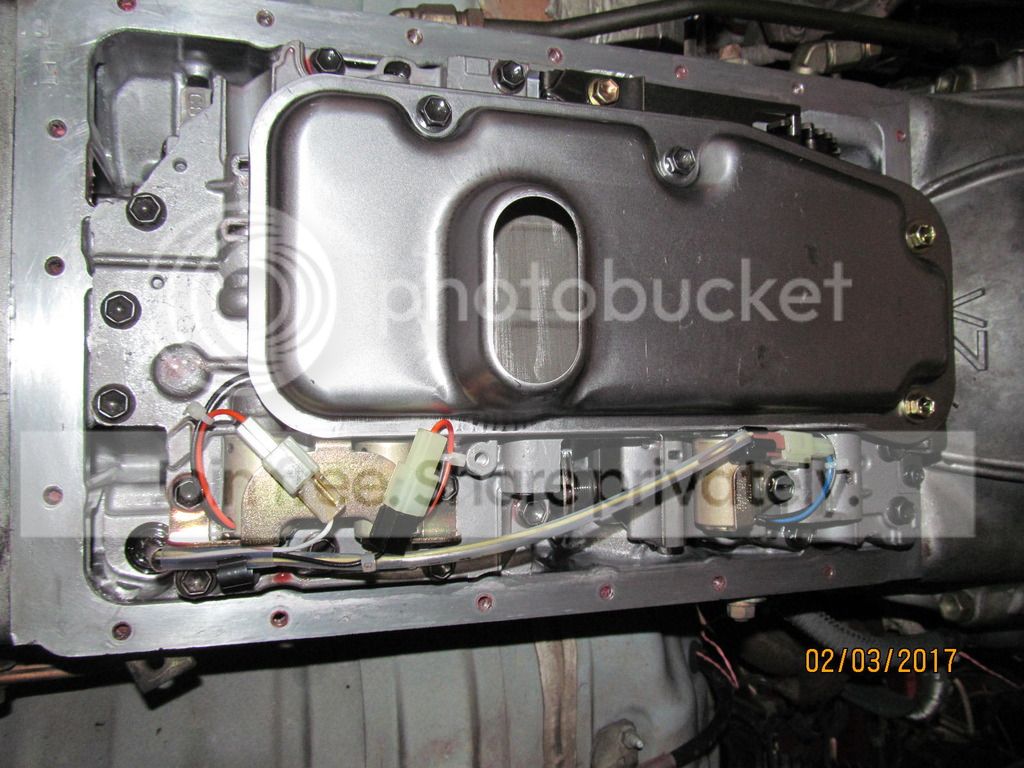

The filter is removed....comes off easy with four 10mm bolts. Another 1/2 cup will come out.
Much better view without the filter.
3 bolts holds 2 solenoids. With the filter in place you cannot get this bolt out.
I think it's 8mm.
Lockup solenoid.

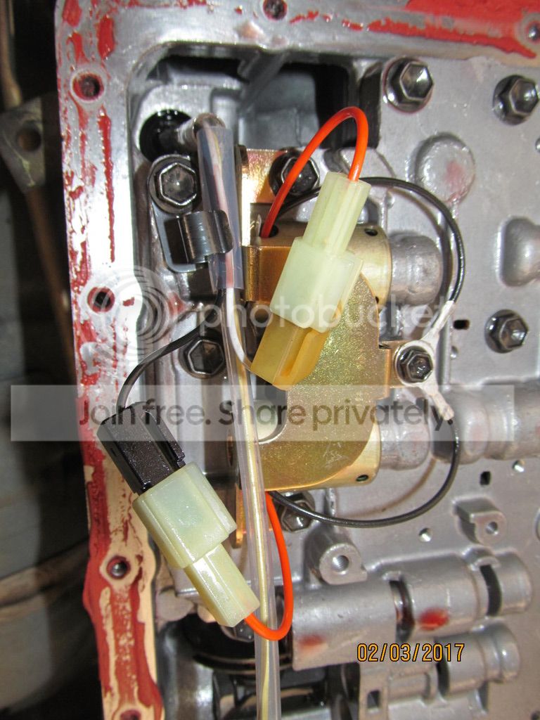

The 3 solenoids plugged right in....the long yellow wire one is the lockup.
the white wire is the 1st solenoid.
Black wire is #2.
The supplied bracket worked nice....3 bolts holds it in place.
The routing of the red wires....who cares.
Another angle of the 2 solenoids.
Last but not least is the lockup.
The bracket fit nicely.
The yellow wire does not really tuck in much.....
so I'm gonna let it hang. No reason not to.
Plenty of room in the pan.

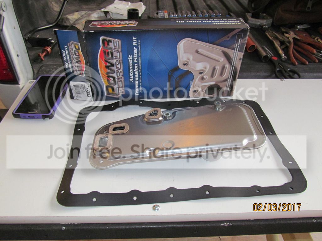

First, I walked to the Irish restaurant ( McDonalds) and had a #3.
With renewed strength, I was then able to make it to O'reilly's and picked up this filter and rubber gasket for 30.
Mounted up with the 4 bolts.

Thoroughly cleaned the orange fipg off with a high speed wire brush.
Magnets had some fuzzy haze of metal on them.
Cleaned this surface too. The solenoids are larger than oem but there were no installation issues.
Buttoned it up and added 4 quarts.
Sorry about the lack of pictures but darkness was coming so had to hurry it up.
Changing the 3 solenoids was easy by the way.
