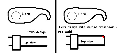

as mentioned above on 86-88 the bolt can sag through the adjuster!!!!
yes...... look up my post on the "broken anchor arm" this happened to my 85 IFS 4x2....
upgraded with a version from the 89 era... new design... diagram in that thread.....

https://www.yotatech.com/attachment....achmentid=4076
