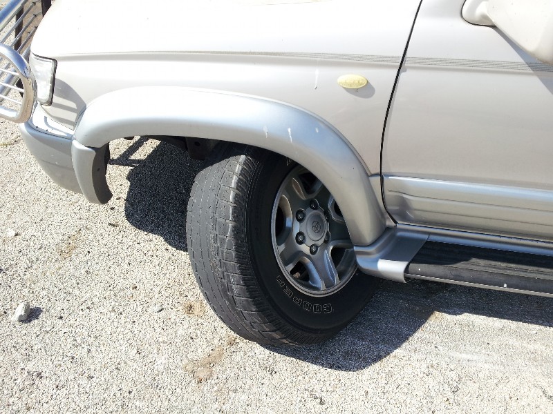

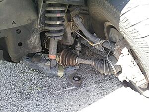

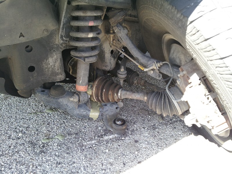

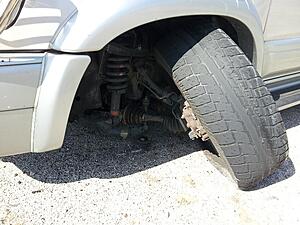

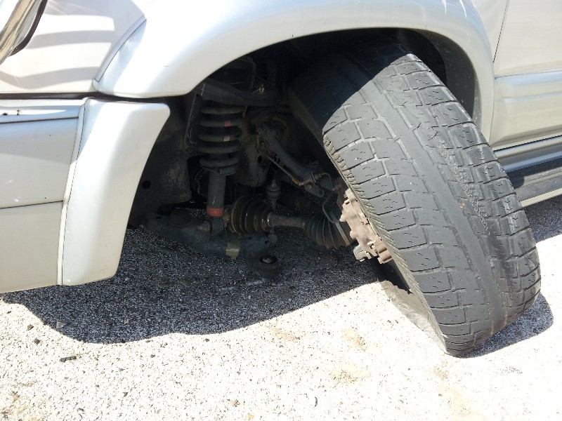

And since my thread was bumped anyways, might as well give a quick update on my truck.
After the balljoint failed in early 2013:
Texas_Ace's 2000 Supercharged 4Runner 2 years later Dyno, Meth injection +more power!-glqmknm.jpg
Texas_Ace's 2000 Supercharged 4Runner 2 years later Dyno, Meth injection +more power!-g5jmes6.jpg
Texas_Ace's 2000 Supercharged 4Runner 2 years later Dyno, Meth injection +more power!-xtqvwpa.jpg
It sat for about a year and a half until late last year when I finally had both a reason and ability to get it back on the road.
Ended up not having to replace quite as much as I first thought. Needed new brake lines, ball joints, axle, alignment, and a few misc things along with a full tune up since it had sat so long.
Total cost for getting it back on the road was around $750 for anyone curious but that was with me being lucky with the amount of damage.
Been back on the road a few months now and still going strong. Turbo project is still planned but will be on hold for awhile as I need new tires ASAP along with no money for toys at the moment.
