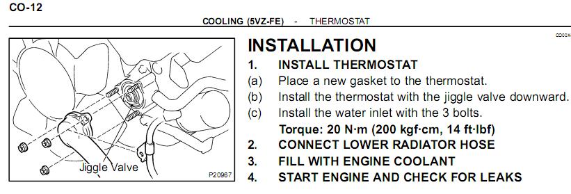

When you replaced the t-stat, did you put the jiggler in the 12 or 6 o'clock position?

For the 3.4, the FSM calls for jiggler in the 6 o'clock position.

I put it at 12. Manual says 15 degrees on either side of 12. Seems like most have better luck at 6.

Switch it to the 6 o'clock position. What manual are you using? I'd not be surprised if the Haynes, Chiltons, etc. have a conflict with the Toyota FSMs for the 3.4L.
I thought that might be the issue. everyone who has put t at 12 has this problem. You need to change it to 6 o'clock
You should use that manual for kindling...

Thanks a ton. Wire connected and temp gauge works. I went over the whole engine bay 3 times prior to hooking battery up. Missed that one. Clip was pinned under the plastic harness, had to dig a little for it. Installed jiggler at 6.
