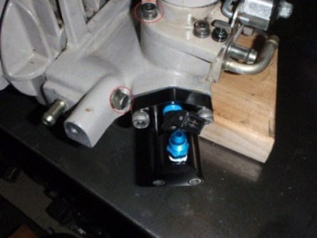

Gen II (Gray supercharger) Torque Specs
I have a 2nd Gen M62 (Gray TRD) Supercharger and was wondering if anyone has the torque specs for the EX Screws that hold the supercharger to the plenum manifold.
I recently removed the supercharger for it's oil change and wanted to clean and reseal everything to make sure eveything is perfect before installing the 2.2" URD Pulley and 7th injector kit.
Thanks
(See Pictures)
Attached Thumbnails Supercharger: Torque specs-p4220040-2.jpg   Supercharger: Torque specs-p4220064-2.jpg   Supercharger: Torque specs-p4220067-2.jpg
