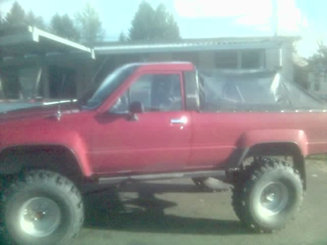

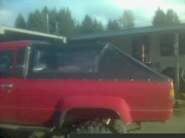

is this what you are looking for?
and the rear

The side are sewn to the top. There is nylon rope sewn inside the top for the rear. It attaches to the frame .Thats how it is kept tight.No close ups of the rear ties or the front part of the frame. ( my camera is broken ) These are actually in another thread here on YT. It is a really simple setup. If I get a new camera soon I wil take more pics.
