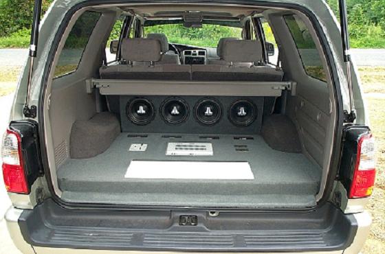

i'm running 4-8" JL Audio's....
https://www.yotatech.com/attachment....&postid=142898

hey broknlgs24...i was lookin to do the same thing in my runner w/ a false floor. do you happen to have any specs on the floor (aka, how'd you get the curve right to go around the wheel wells, etc)?
Also, do you have any cooling system in place? I would imagine the heatsinks on those amps would get kinda hot. i mean i know the fins are in open air...
btw, nice job. looks awesome!
