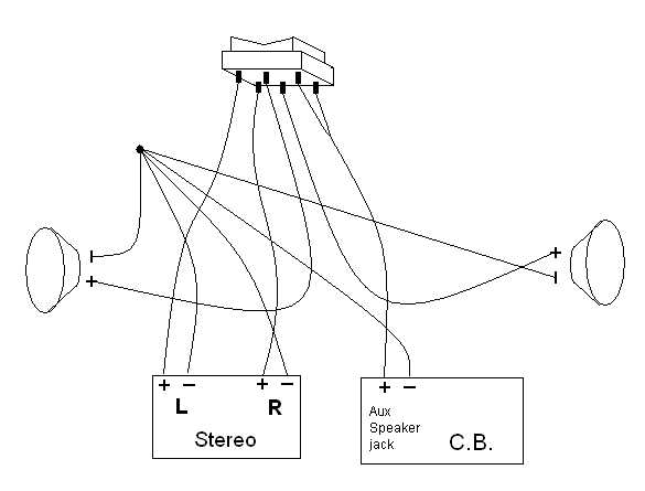

I want to use my Front stereo speakers as auxiliary speakers for my in dash C.B. radio.(they are just the old stockers)
I'm no electrician, but I'm pretty sure I can run all the Positive leads through a 6 pin rocker switch and clump all the Negitive leads togeather.
My goal is to be able to turn on my C.B., hit the rocker switch, moniter the C.B. from the front speakers and still be able to have the stereo on in the back speakers.
Has anybody done this?
Anybody think this would work? Does this make sense?
I don't want to try to find a place for an external auxiliary speaker. I want to keep the install as clean as possible.

"Just a thought. I smoked an amp by feeding an open circuit "
That sux Rob. Well I'm not useing an amp. I don't think my 3 year old Kenwood HU will fry. I have the fader adjusted to 70% rear caus' the front speakers are so crappy anyway.
I don't have a digital camera....Yet....but I'll keep Ya'll posted on how it works.
I attached a lame drawing of how I'm gonna run the wires to the first post, if ya'll wanna take a look...and thanks!

I saw your drawing and I would do it differently. I would use a switch that allowed me to switch back and forth without combining the grounds, but that is just me. I am big on isolating circuits if there is any chance of voltage feeding back up a line. I could be concerned about the potential of the stereo taking the CB out or verse visa, but I can't say your way won't work.

Lt. Dan u might want to run speaker wires in series to the switch first. Might not get as much volume since 2x the impedance. I ran mine in parallel and have no problems.(12 years.) Can't say exactly if it will work for you. and I didn't run the grounds together either.
Check diagram:
http://www.avatarspeakers.com/wiring%20diagrams.htm
