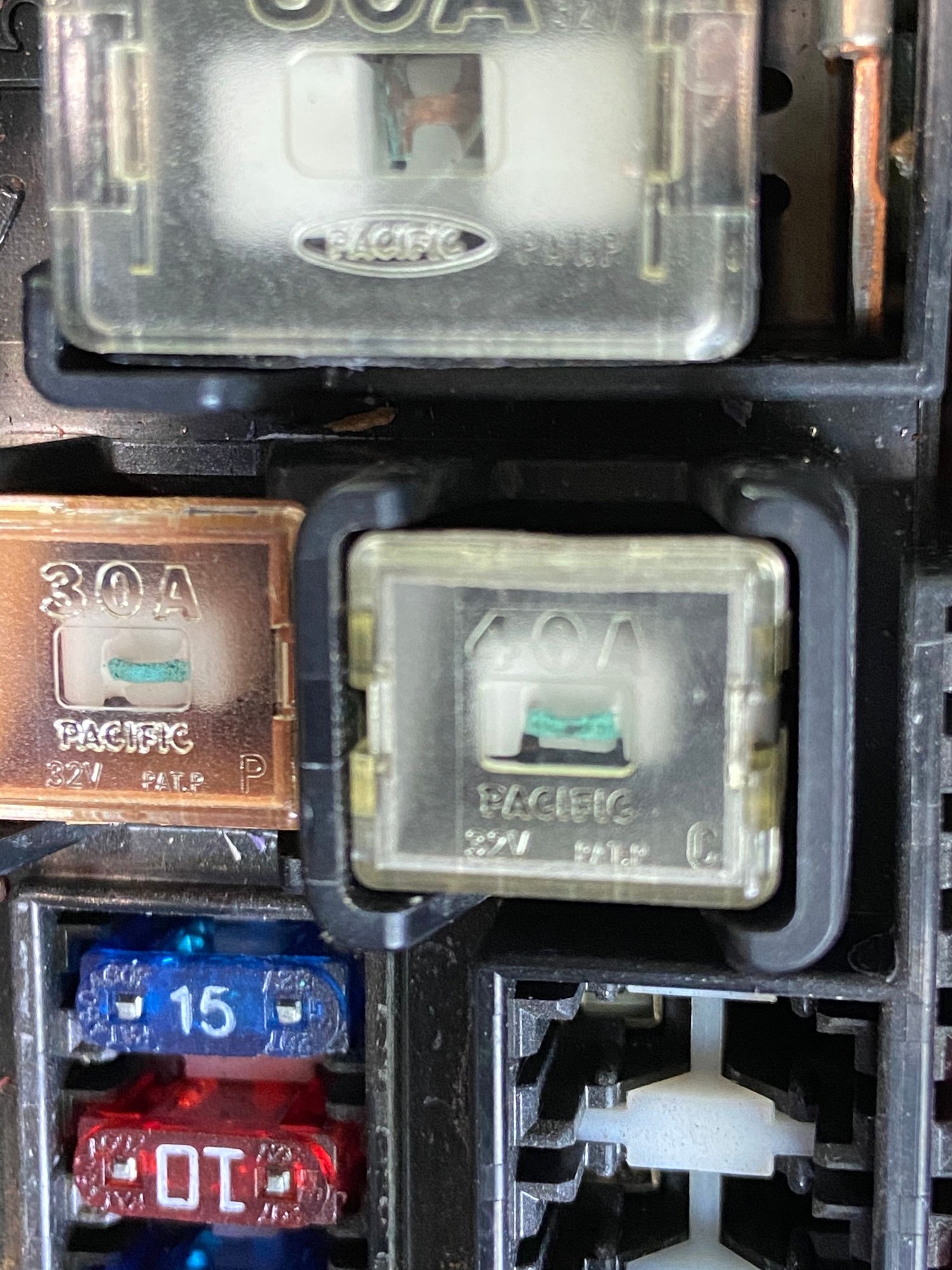

I have replaced the terminals, same results. When I connected a cable to the exciter wire and tried to do that test, before I even started testing I got a -.11 on the voltmeter, when I turned the key, it goes to 0.00
so Im at a point where Im confused about why the 0.11 and about ready to pull the wiring harness off and inspect it thoroughly for cracked or broken wires.
also, my AM1 and AM2 fuses are corroded... headed to AAP to replace and pray...

Remember, those (AM1&AM2) are bolted in from underneath. The fuse block comes in half, so you can get to them. You unbolt a couple of bolts, and release a catch to get it apart. The top half just lifts right up. Easier than it appears at first.
Good luck to ya! Keep us up to date on how things are going.
