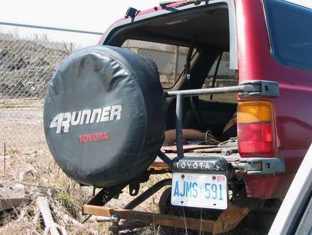

part one
Attached Thumbnails Spare Tire Rear Mount For 2nd Gen I Need One!-resize-img_3262.jpg

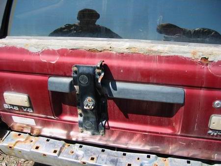

part two
Attached Thumbnails Spare Tire Rear Mount For 2nd Gen I Need One!-resize-img_3261.jpg
