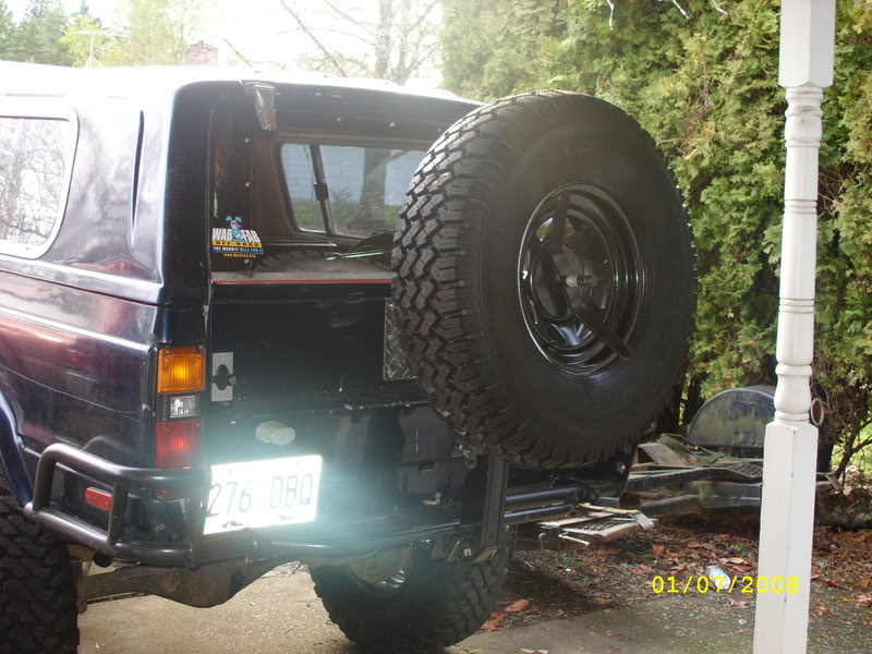

Originally Posted by rdang
Is there much rattle in this one? I went to their website before but didn't see where I could order this, do I have to contact Steve directly? Does he ship to Canada? If I thought it was a pain to take off on on, what sort of security device can I get for it?
I mounted this one on my '81 Trekker today. It is the used one I got from millerPKA. I drove the truck around today with it on and there is some movement. I did not notice too much noise, but my truck is 26 years old and I have gutted the interior so all the noise pretty much blends together.
It used a standard 5/8" Hitch pin in the reciever, i used a locking pin there. The tire mounting bracket has a hole in it, I enlarged that a little bit so that I could get a paddlelock through it to secure the tire. I am not sure how long millerPKA used it, it was worn but seeing one of these in person I am very impressed with the quality, design and workmanship. It is very easy to get up and down. I have got a 33x9.50 spare mounted on it.
It did add some length to the truck but I am happy to regain my cargo area.
One thing that I am considering doing with my rear bumper is adding a second reciever over a few inches to the right of the center reciever so that I can still have the center for a reciever shackle, though I do have a shackle point on each side of the bumper.
When I first found out about CBI offroad I emailed Steve with questions about it and that seemed to be way to order. From what I remember he makes each one to order and needs some measurements for the vehicle application. Mine sticks out a little more that I would prefer, but I am sure that I ordered it directly from CBI it would have been a better fit, but I am happy with what I paid for it used. I am sure that he would be willing to ship to Canada, he is in Idaho.
