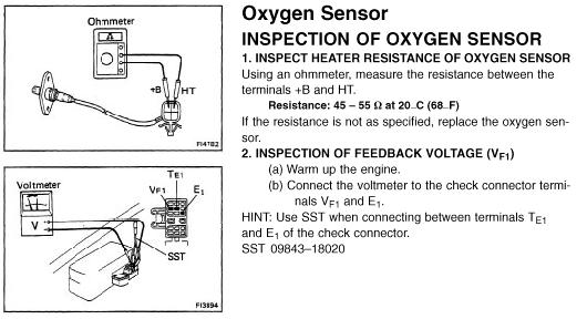

if it goes out, then you'll get a CEL. if it's on the brink of going out, then you need the FSM procedure for testing it using an OHM meter.

nope. if you have bad mileage, it could be malfunctioning but not completely out of order. get an OHM meter and find out what it should read and check it.

An OHM meter is a multimeter....this is the one I have http://www.sears.com/sr/javasr/produ...26+Accessories
The O2 OHM test is here....https://www.yotatech.com/attachment....achmentid=4531
Pretty straight forward test....hope this helps
