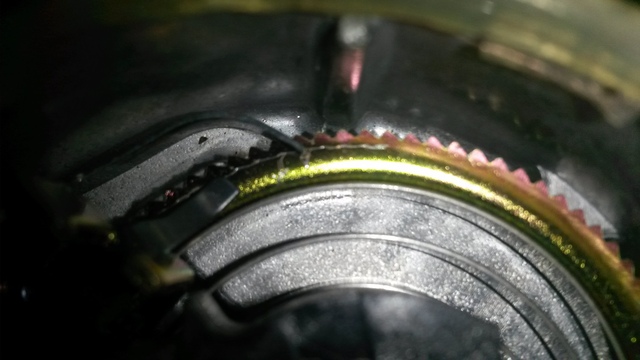

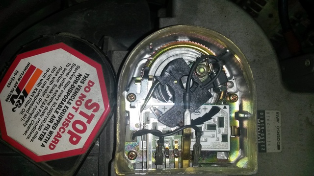

if you have the$$$, then why not?, but you want to know the gearing long before you go that route, and rely on experience from many..... but i spent years just playing with the etc button, and adjusted the vafm. i'll try to remember to upload pics later, but i basically ended up loosening the spring about 4 notches, and found it rested between 2 factory score marks on the ring. for years i always thought to myself that the factory trans tune was meant for an engine with more torque, so that's what i gave it. as far as tuning goes, there are many tables, but the ltft is dependant on the o2 readings and octane. if you don't know what that means, it basically means that by manipulating the afm you gain throttle response, loose premature low octane modes (which will waste premium fuel) and advert unnecissary kick-down, yet, if it should be too rich for long-term driving, the 02 sensors will cut the fuel back while cruising. it's a free mod, and reversible, as long as you mark the factory position with a sharpie. it was said toyota that made me really see the ironic fact that lack of fueling can lead to wasted fuel consumption/ via rpm's. and again, never underestimate the rolling resistance of your tires. 5psi under can kill many mpg, no matter what you drive. speaking of, just what "mud tires" are you running?

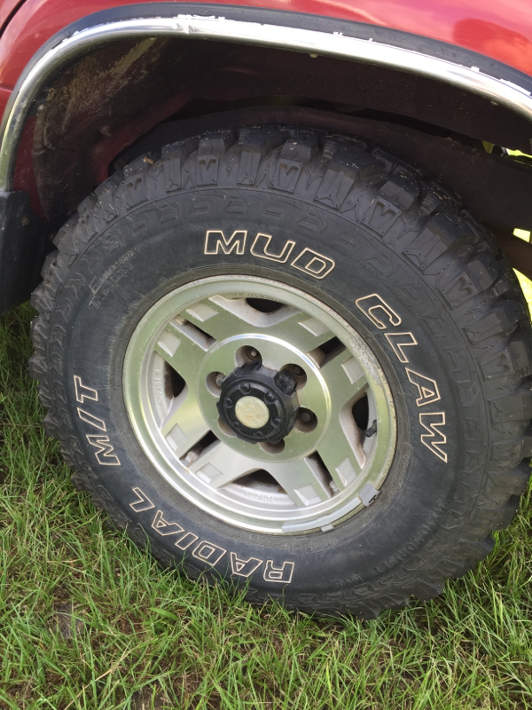

I'm running these. Mud Claws.
They have pretty aggressive tread. And if you could post those pics of that mod you did that would be awesome!
Size:  124.3 KBName:  20150826_165631.jpg
lets see if those work. you can see the tang that holds against the teeth, you can tighten it (leaner) by turning the disk clockwise, but you have to push the tang out to let it turn ccw. it's not a whole lot of spring pressure on the ring, but be careful not to let it unwind freely. just use a screwdriver to let it slip one tooth at a time. you want it warmed up good to operating temp first, then go one notch at a time until it revs crisp without raising the idle. as you can see, mine landed on the 2 marks that were already there from the fatory. if you don't like it, you can always put it back.
on a side not, i did gain better milage running premium. if you don't, i would check the ignition timing, o2 sensors and general ignition system component wear. your fuel gauge work? i don't know about this engine, but most do an octane check at each fuelup and sets timing retard if the knock sensor senses detonation.

lets see if those work. you can see the tang that holds against the teeth, you can tighten it (leaner) by turning the disk clockwise, but you have to push the tang out to let it turn ccw. it's not a whole lot of spring pressure on the ring, but be careful not to let it unwind freely. just use a screwdriver to let it slip one tooth at a time. you want it warmed up good to operating temp first, then go one notch at a time until it revs crisp without raising the idle. as you can see, mine landed on the 2 marks that were already there from the fatory. if you don't like it, you can always put it back. on a side not, i did gain better milage running premium. if you don't, i would check the ignition timing, o2 sensors and general ignition system component wear. your fuel gauge work? i don't know about this engine, but most do an octane check at each fuelup and sets timing retard if the knock sensor senses detonation.
So did you turn yours ccw or cw?

lossened the tang so it went ccw. i came up on old school carb tuning, so i learned the feel..... which is a certain learned talent, but you want it to rev crisp without lag, but you don't want it to sit rich at idle and ramp up on it's own.
