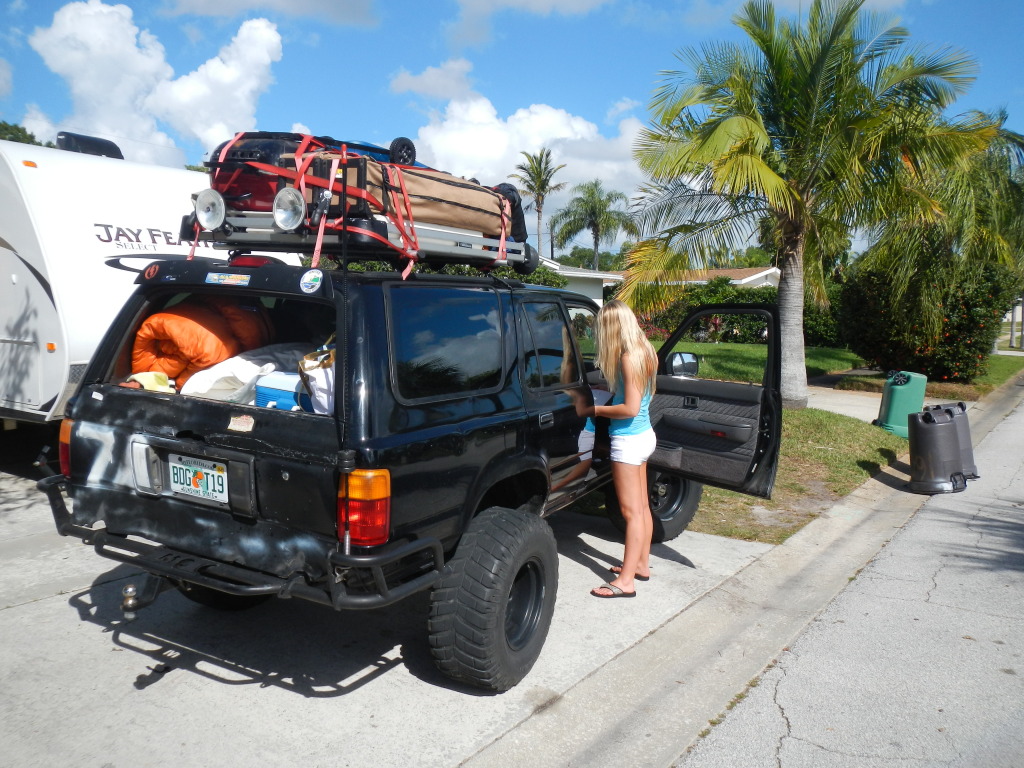

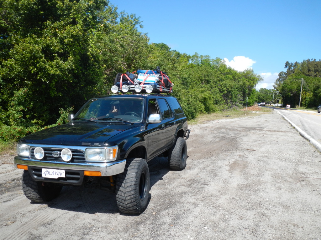

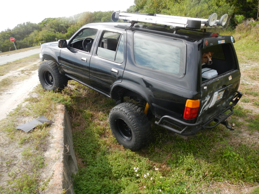

stockwell45 yes it is possible...
you just have to cut were the feet slide in and out, to adjust for defiant vehicles. i cut about an 1inch and a half longer track and it works great as u can see!
