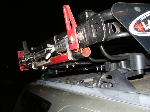

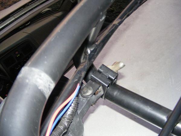

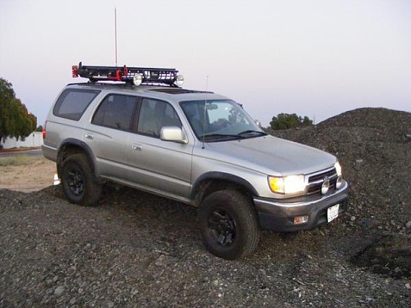

Thule M.O.A.B Rack
Ok so here is my rack! I have looked everywhere for accessories and haven't had much luck. So why buy when I can make. The Custom Hi-Lift Holder was made a friend, which took alot of ingenuity. It's lockable and secure. I also go fishing alot and I needed someplace to mount the fishing poles, since my 94 4Runner didn't have a moon roof I mounted them inside. When I bought the 99 I didn't have that option. So I mounted The Berkley Rod Holders on the crossbars. Next were the lights, again pay 100 dollars of more for the brackets/mounts. I instead used $10 Yakima bike track holders, drilled a 3/8 hole instead of a square hole and use a wing nut to hold the light. Its really secure and easier to mount lights anywhere.

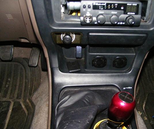

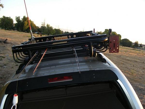

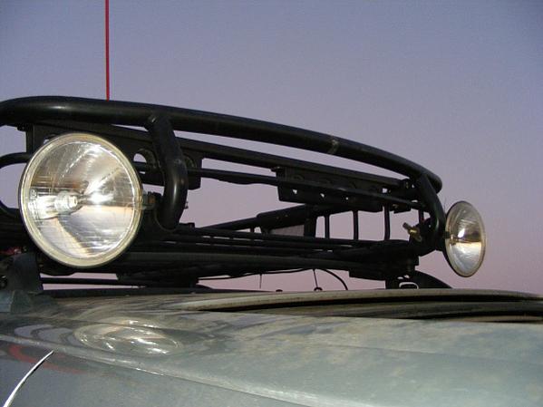

Thule M.O.A.B. 2
Unfortunetly I can only add three pics Here's Some More Of The Rack, The Lights and The Light Switch in the Cubby Hole next to the Aux 12V Plugs
