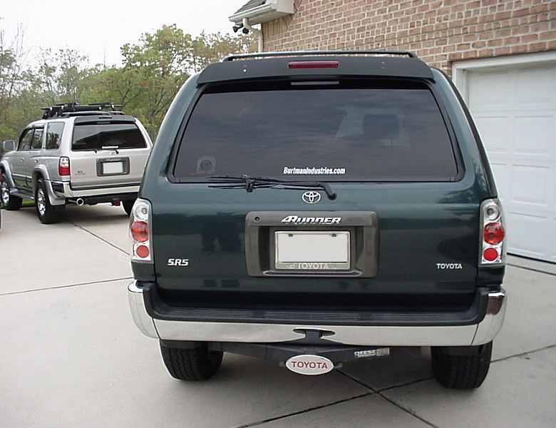

A pic at 7am after he stole my tails and hitch cover, hehe.
If anyone else wants a "Burtman Industries" sticker, email me with addy.
